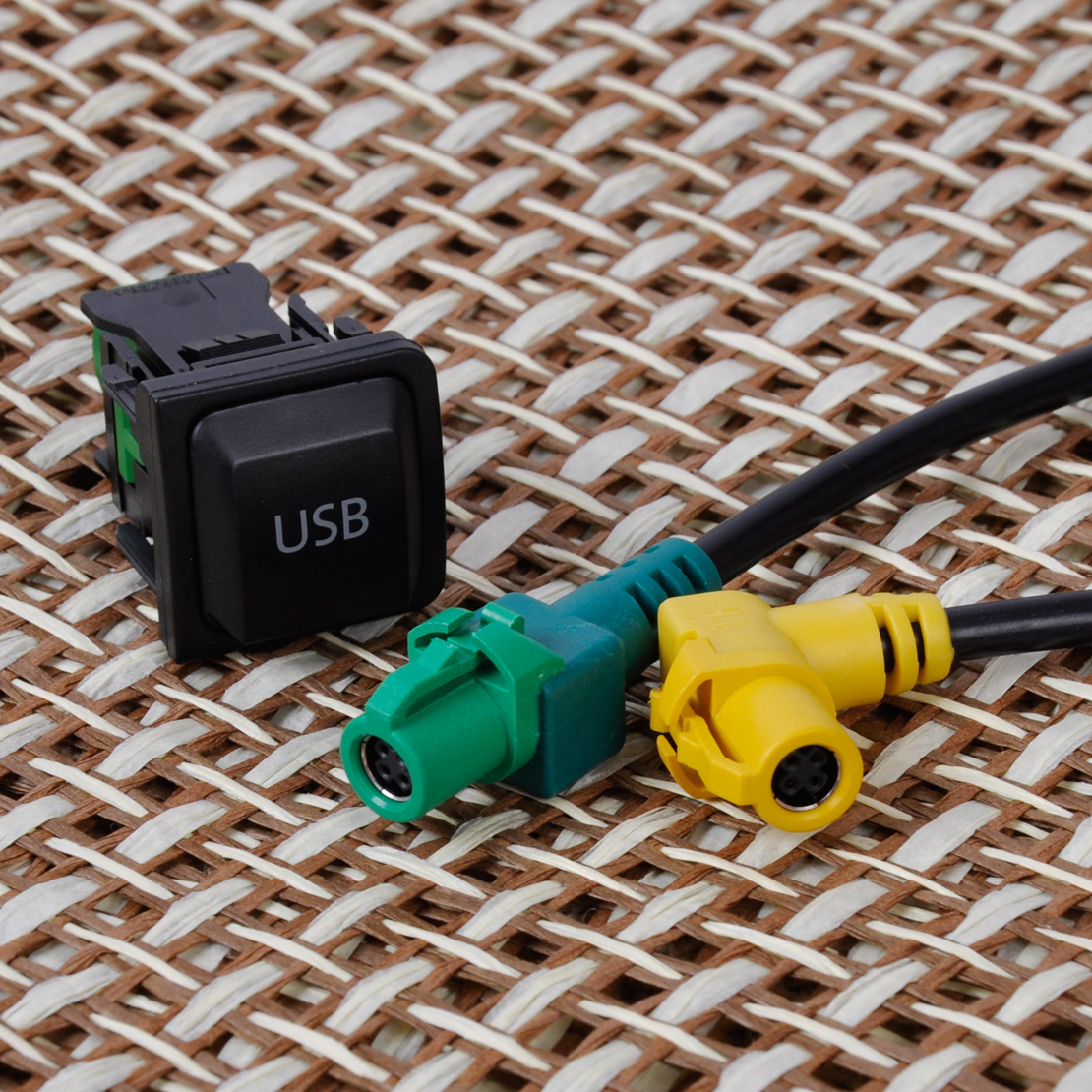

Offline kingraza27
  • Posts: 38
Re: Erisin head unit
« Reply #24 on: January 25, 2016, 07:43:09 pm »
ah,
in this case. I would assume/recommend you do some cutting and make your own cable.
You will have to buy 2 USB switches and acquire 2 usb cables(can be of anything).
Then you will have to cut the cable of the switch and the second cable.
From there, all you need to do is solder the cables and that should give you 2 switches that will plug straight in the unit.
Offline Vwgtiking
  • Posts: 807
Erisin head unit
« Reply #25 on: January 25, 2016, 08:07:25 pm »
Sounds like a good idea. Surely the 2 VW USB switches are 2 female connections? So I can't  plug into back or am I missing something?
Offline kingraza27
  • Posts: 38
« Reply #26 on: January 25, 2016, 08:18:33 pm »
It comes like this.
And the yellow bit goes in the back of the head unit.
So if you were to chop that off and add a male USB connector. It will work for you.
