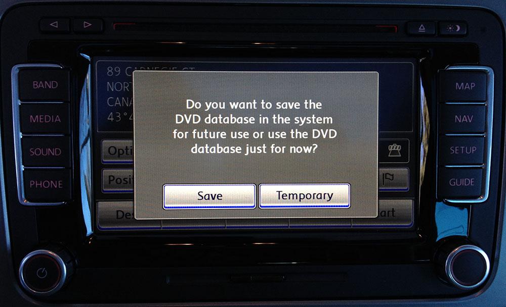

If I press eject it saying this:
I never get this :  I need to get this to install or not??
please any help thank you all

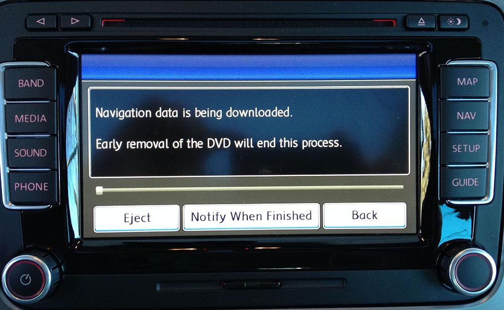

When i put the dvd navigation V13 in, it says nothing. When i press navigation or map it works good perfect. When i press eject it says that it is dowloading like the first image above.
When i press on the screen on eject it comes out the dvd but it asking for dvd navigation. So the navigation is not on the HDD.
Now i want this on the HDD. What i did i put it in and wait wait wait. Its starts everytime over and over. So think i wass more than an hour waiting then i turned it off

Normaly its need to say SAVE or TEMPORARY

If when you press eject it says that it's copying you still have to wait. If you keep an eye on the process you'll see a bar growing. If the bar restarts, the RNS-510 couldn't read the DVD properly. You'll have to clean the lenses as I've explained before.
The copying process will only be successful when you press eject and no information message appears, just the DVD will eject right away.
