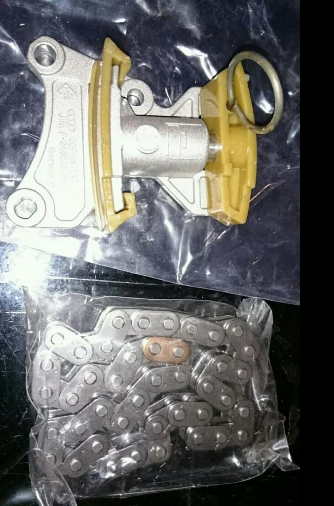

Not sure tbh. This is the photo from the advert from the sellers page
The description just says brandnew chain and tensioner nvere used.
The colour of the plastic on the tensioner is a darker yellow then the oem tensioner I think

I wouldn't worry about any of that yet just see how you do with the leaks etc.
Re: URGENT oil pressure stop engine
« Reply #546 on: April 03, 2016, 05:06:09 pm »
Looks gen. to me

Looks gen. to me
Completely different.colour to the one you posted a few pages back.
Will leave for now as advised and just search for an oil leak
« Reply #548 on: April 03, 2016, 05:41:45 pm »
OK. It looks to be stamped the same as mine.

Does different coloured plastic indicate a knock off then? Like they got the stamp right but the plastic wrong :signLOL:
« Reply #550 on: April 03, 2016, 06:43:58 pm »
It wont be a knock off I dont think. Not with Audi stamps on it. Copied parts usually had different markings.
