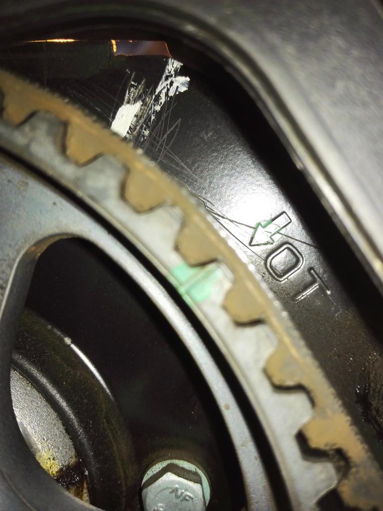

Crankshaft at tdc
In this pic it looks corectly timed
But then if I move the phone up or down
I think it looks most perpendicular in the second photo, which makes me think it is timed correctly

Unto the two bolts holding the top of the cam cover.  Then see where the rear of the tooth on the pulley lines up to.
