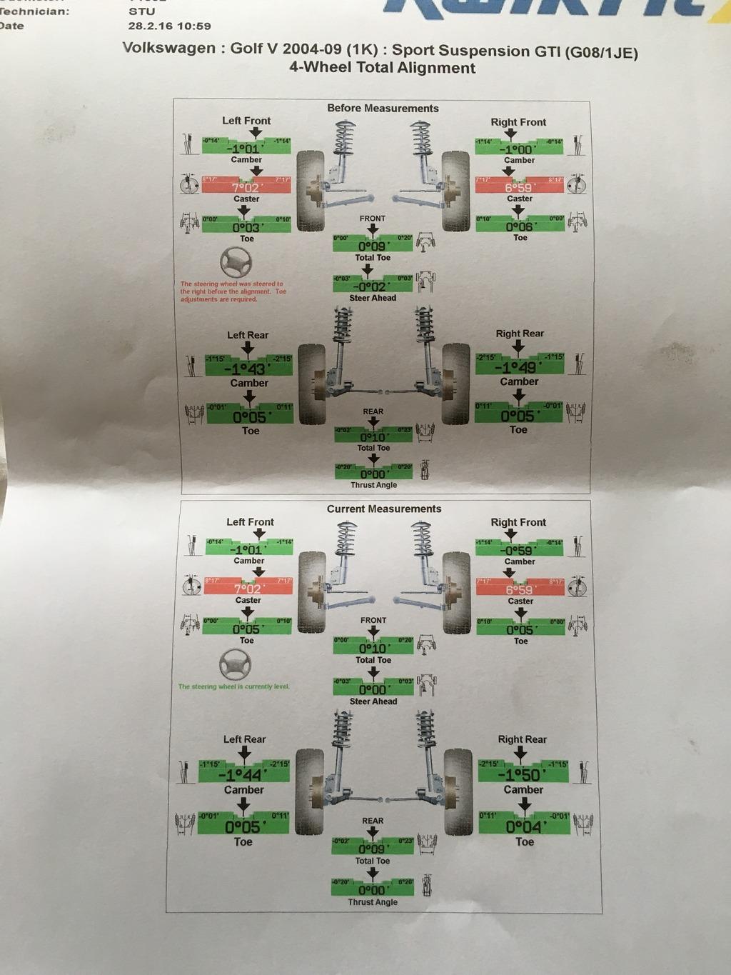

« Reply #15 on: February 28, 2016, 12:13:10 pm »
Haha. Well despite Rich's, and to be honest my own apprehension of Kwik-Fit, I visited my local branch this morning. They have a Hunter alignment system and I was one of the first there in the morning. So I gave it a go, as I was majorly pissed off about the steering.
They've corrected the steering and it's now straight and true. The front toe on both wheels was completely out; i.e., it had not been corrected. Below is my print out. Half a mind to go back to where I had it done yesterday and ask for my money back.

« Reply #24 on: February 29, 2016, 03:40:00 pm »
That's a bit weird.  Assuming "Before...." is how you took it to them and "Current....." is after their adjustments, the toe was actually OK but now they've aligned it, it's untrued the front camber?

« Reply #25 on: February 29, 2016, 04:00:28 pm »
On the 'before' printout, the steering was turned to the right to straighten the wheels. If they weren't straightened, the toe reading was way out. It's a bit of an odd way to do it, but it's definitely correct.
The front camber on the MK5 can't be adjusted.
