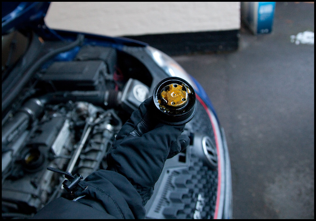

If your head gasket has failed you won't have compression in one or more cylinders.
This is a picture of the milky deposits from my car this winter:
This is the first winter where I've noticed it; I think the unusual cold must be a causative factor.
The US forums have been reporting this for a few years now, nothing to worry about.

Is it me or does it look like a Ninja or SAS op is checking your oil.  :signLOL:

And what strange milk you must drink because it looks yellowy to me!
 :signLOL: that's my full arctic circle getup :D
...and if my milk was that colour rest assured I wouldn't drink it!
