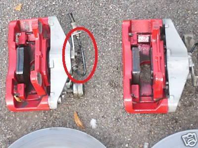

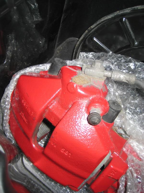

GTI  front Brake hose fit..
S3/R32 Front  Brake hose fit showing the small bracket and the small connection pipe.. (circled - not my pic)

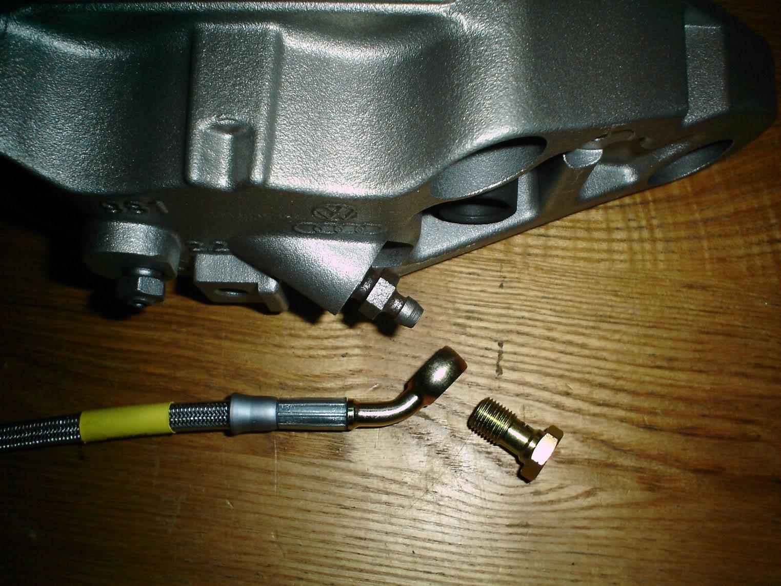

The other option is to go with a braided hose/banjo bolt arrangement that removes the requirement for the small connection pipe..  (again not my pic)  The Braided hose could also be fed through the bracket and a rubber grommet used, or secured using a P clip, secured to the caliper using the threaded hole left (far left bolt in the pic)..  Talk to Dave B 1970 from this forum for further advice and hose availability.
Hope that helps..
