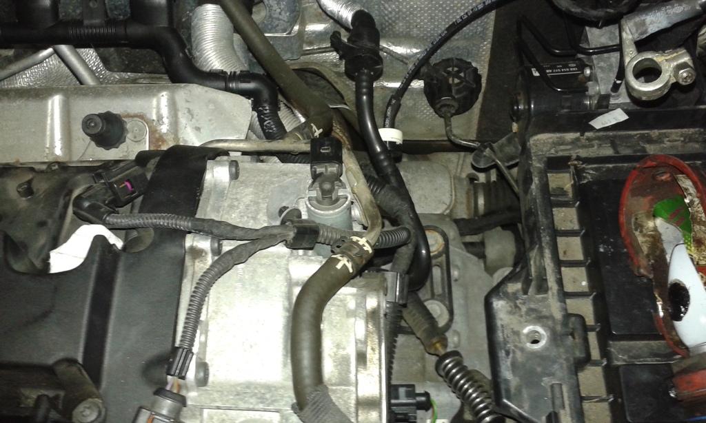

« Reply #19 on: April 03, 2016, 07:41:29 am »
Yep, the thing in the middle of the picture below. Helps to work with faultcodes, but you can check the functionality of this valve with VCDS and check the timing with it.
