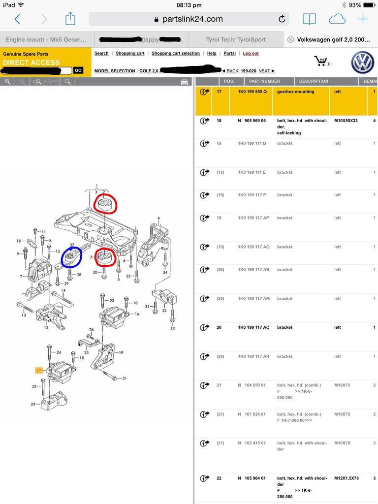

At first it made no sense what you wrote above. But after looking at the catalog i get what you mean. Do you mind showing me where the other bush is please from the below?
If i have to take the subframe out I'd order the stretch bolts for that too right.? Btw deadset frame bolts.  Omg drolllll

What I have circled in red is the upper and lower mount. And where I circled blue there is another bush there.

@raz469 check your gearbox mount as this is another common one for perishing and cracking.
