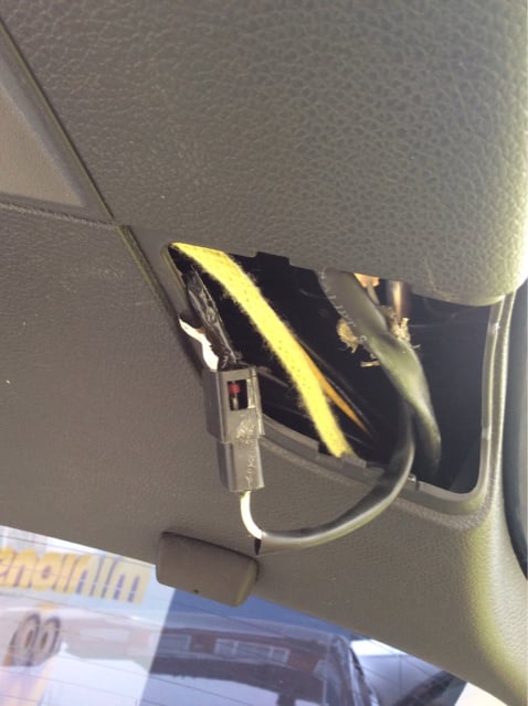

The wires are fed through the original cover can do it but takes time. The three colour wires are so the lights inside the tail gate light up. The reverse wire i had to make another connection from the left so it could reach to the right side. You have to make extra two wires.

NOOOOOOOOOOOOOO  :doh: :doh:
Why did you cut through the rubber grommet  :slap: You could have fed the wires through it with a coat hanger or similar as this looks awful @axsweb

You can't swap around the reverse and the fog cables as it's illegal to have a Fog light on the opposite side. The only way to get around this is to either swap the lens covers OR buy a red bulb to replace, but that means the reverse light will be red also.
Not a simple solution either way
Oops.... Oh well I'll live with it now.
I didn't know it was illegal.
