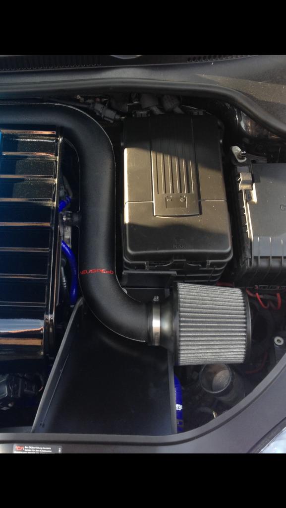

No one makes one dude, I gave up after a year and made one based on the Revo intakes
Really like the look of yours mate ... how did you do it? Do you have a template

I did do somewhere yeah. Just made bits out of cardboard till it all fit then cut it out of 2mm metal and pop riveted it and bent it all into shape!  :happy2:
Not trying to P1ss on your parade but would ti be more affective if the heatshield was aiming towards the cone filter for a direct air feed?

« Reply #6 on: April 27, 2016, 08:15:06 am »
I get what your saying.
You are restricted in a few ways because the parts underneath the shield are limited to where you can attach the shield to.
The filter is very right and the feed off the grill is very left so you struggle to get  Good angle and still be able to screw it to the oem position on the front panel.
The height and slope of the bonnet makes it easier to put the shield where I have it.
For the 45mins it took to make it'll do for me  :happy2:
I sprayed it through the he front panel with my airline and cold air defo meets the filter as it is
