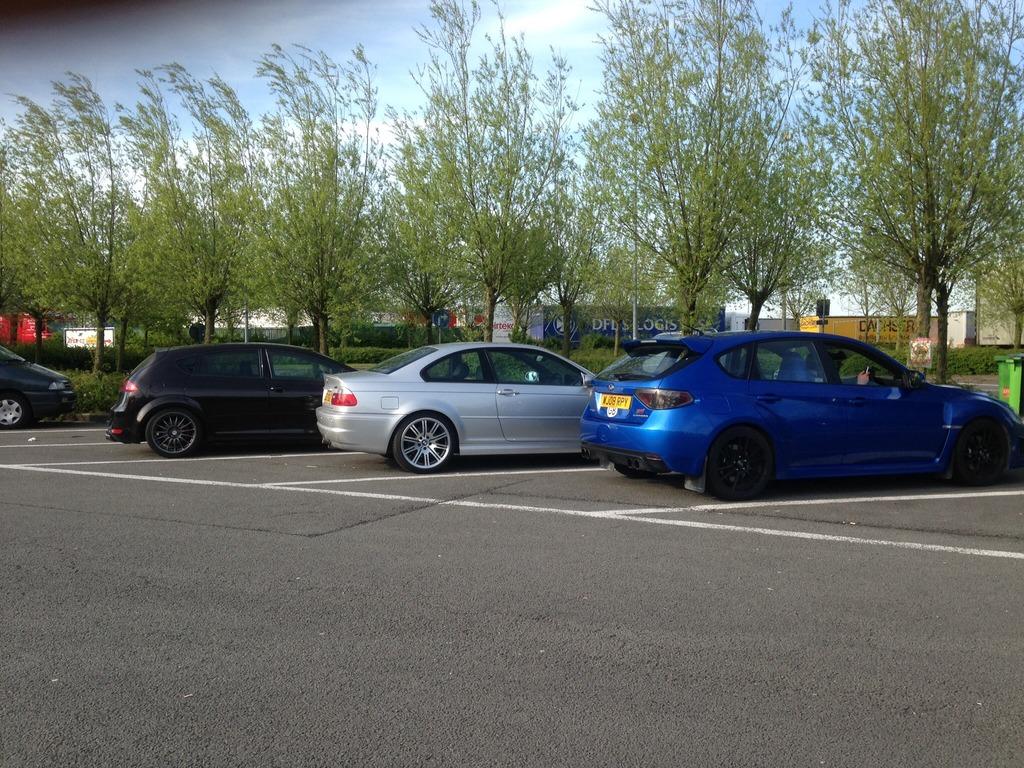

Everything was ready for my first Nurburgring trip!
Out of the 3 the Cupra was by far the quickest car which I was surprised about, but I'm sure the M3 would have been the most fun to take around the track.
