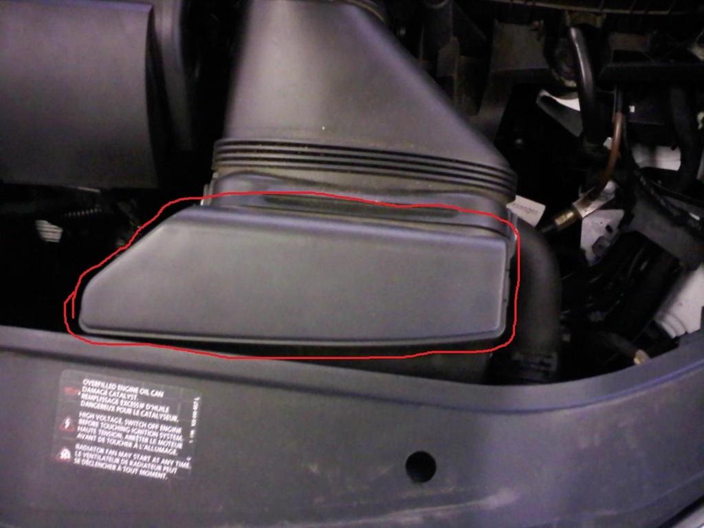

Hi Guys,
Can anybody advise me of which part this is,
Its the Air Intake Cover

1K0805971C ?

I am also missing this part, reading up its not the best of designs. I am reluctant to swap to a full induction kit as Im not sure if the added noise would become irritating.

I've 'glued' mine on with a bit of black silicone, as i've seen this top part break free and cause other damage.
I've also replaced the two front plastic mount points with small metal ones glued and bolted to the body of the unit, as once had broken and the other was showing the white cracks of failing.

1K0805971C ?
But i think that is the complete unit model number.
Yes thats for all 3 parts, but thank you for that number as they could locate the other number for me which incase anybody else is looking for this part is: 1K0 805 965C - TPS quoted my £3.52 + VAT
