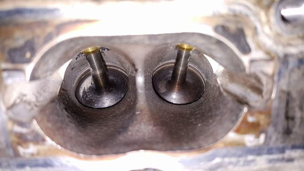

Get it walnut blasted as the other 'quick' options do nothing. This was the result after AKS Tuning did mine.
Before
After
They're in Bedford and well worth a trip there to get stuff done properly.
Before
After
Can I ask how much they charge for this as I'm looking to get mine done soon?
Before
After
Sent from my SM-N910F using Tapatalk
I was quoted £352 yesterday and it takes 4 hours
Before
After
Not sure tbh as I had it done with loads and loads of other stuff.
