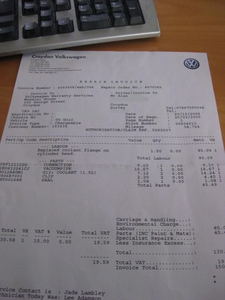

TC is bang on the money, I indeed had the same problem.
If you are losing coolant and it constantly requires topping up (in my case every 3 - 4 weeks)  this could be because there a leaking flange (tell me you didn't giggle when you read that . .  :grin:) where the coolant goes into the engine and all that (technical description there).
It is covered under warranty or (in the case of VW Croydon) cost £180 inc labour and parts. This has been the case for a few people I know who have had MK5s.
Attached is a copy of the invoice for the works carried out which might be of help:
Any other questions bitches !?

I had the same slow leak problem and also always have dry cardboard under my engine bay on my garage floor to be able to easily see any drop of fluids - No coolant drops evident.
Turned out to be the seal on the engine as AlanD's but my VW dealer didn't charge me as much his and mine had to remove and reinstall my Forge Twintake as well.
Signs of leakage would be on DSG box if you have DSG.
It tends to happen in a cold spell if you don't drive for a while - When the engine is warm it effectively seals the faulty seal by expansion.

had ahead gasket test done yesterday and givern the all clear phew !
anyway today i had a pressure test done on the cooling system, and yes i can now verify that my car has exactly the same problem as ALAND's
part was ordered today and getting it fiited Monday
