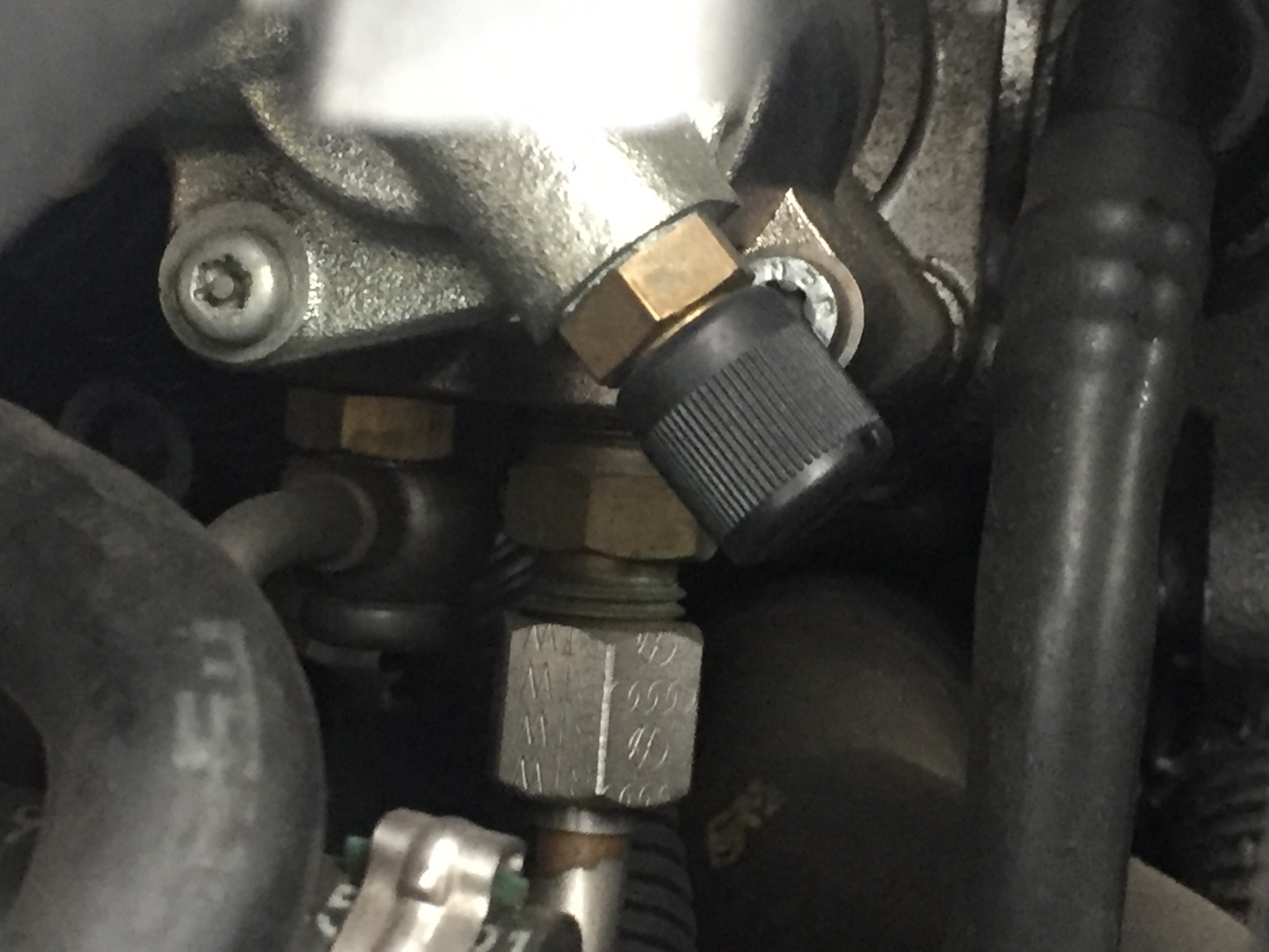

Thanks guys. But i don't know what it looks like :s
Does this one have a banjo bolt?

« Reply #4 on: June 10, 2016, 08:44:53 pm »
Yep banjo bolt  :happy2:

« Reply #5 on: June 11, 2016, 02:14:20 pm »
The banjo bolt is the bolt on the left with the metal pipe connected, disconnect air intake and sensor plug top left of engine cover, pull engine cover from each corner to release the bungs (needs a good tug) disconnect fuel pump plug, stuff a rag in underneath and slowly undo the right hand pipe first and release pressure. Then you will need a m8 triple square to undo u the left banjo belt from underneath ( this is a pain so be patient and make sure socket is in properly so you don't strip it, and mine took some doing up after to stop it weeping ) disconnecting the pipe fom the pcv helps a lot. The rest is easy 3  bolts to take the pump off ( don't over tighten them when you put it back

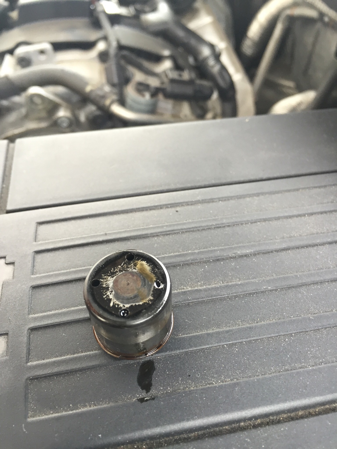

Managed to get the pump of and change the lil tappet. Not difficult, just long. They so much smaller in real life. My worn one below.
Theres hardly any space to swing your ratchet so the banjo had to be done 1 click a time. Didn't care as no damage was caused and it worked. Shame about the two buckets of sweat i lost
My cars a BWA, so why does it have a banjo? Is there other things i could have different to other bwa?
As always all comments welcome. Everything is fixable if you know what part to fix.

« Reply #9 on: June 18, 2016, 07:39:29 am »
Follower looks f*cked. You need the check the cam lobe peaks for wear

« Reply #12 on: June 29, 2016, 04:36:51 pm »
The follower is weird, i almost feel like its a fingerprint of different owners. No prizes for guessing me.
But the wear marks really are distinctively different. The most central one is so well grouped and was there for so long started to rust.
I think the next owner moved this wear to to the larger 'black' circle, no rust.
