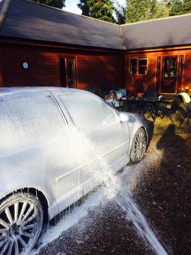

Hi all
Between owning my first edition 30 and this one I also had a MK4 R32 for a few months so I thought I would share it with you guys, I am quite into detailing now and have a rather large amount of products etc I bought this and Made a cheeky £1,350 on it by just detailing it and fitting GT100 miltek tips to the old style rear silencer  :innocent: . The story with the R32 was I didn’t like it nor did the misses so I sold it, was worth buying one though as the V6 sound is something else  :P
90K
AMD stage 2
Miltek manifolds
Miltek catback
AP coilovers
OEM satnav
Highline
Xenons

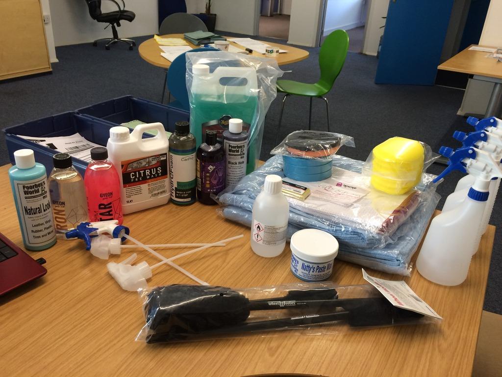

Few parcels have arrived this week, got a few top ups for my detailing collection as its getting a little low on some products. I am going to try the Gyeom tar and iron fallout stuff, anyone used it before? also going to try poorboys Nattys blue paste wax as i havent used it before. new wheel woolies as the dog ate 2 of them  :fighting: literally . another Guzzler drying towel as mine has gone a bit sh*tty in the washing machine  :sad1:

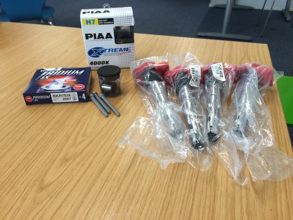

Also got my R8 coilpacks, NGK 7's and camfollower with new bolts & oring + some PIAA Xtreme bulbs

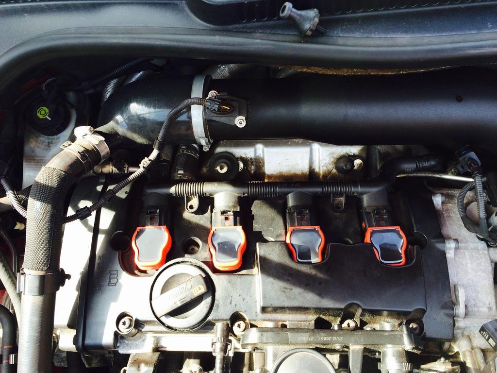

Done a few bits on the eddy today, apologise for the dirty bay, still haven't detailed the car yet either :ashamed:
Fitted new ngk 7 iridiums along with R8 coilpacks
You'll notice I removed the oil filler neck as well as I personally think they look stupid once a cai is fitted.

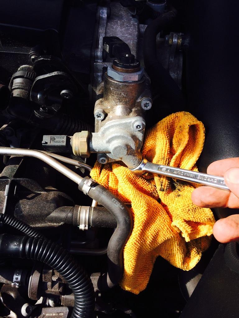

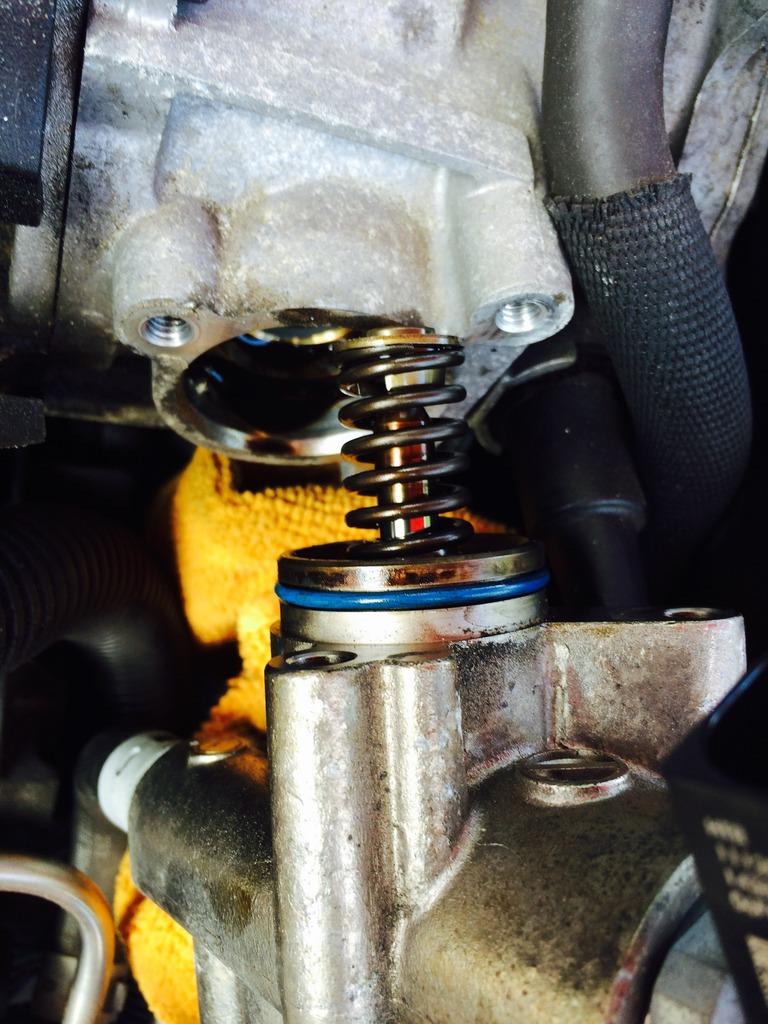

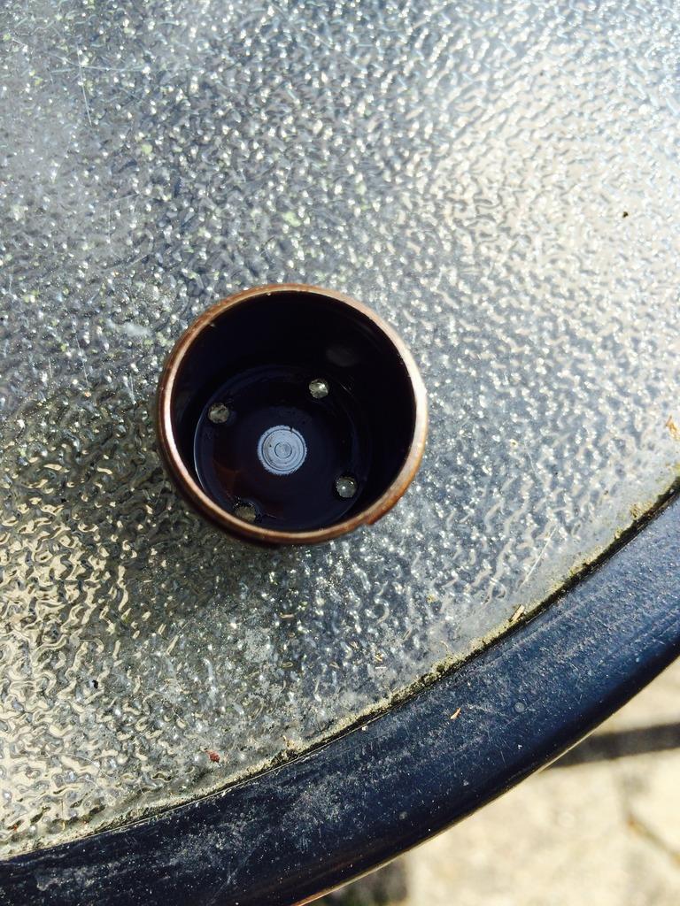

I then tackled the cam follower, easy job took about 15 minutes.
Fitted a new oring, glad I did as when removing my original it broke into 6 pieces.

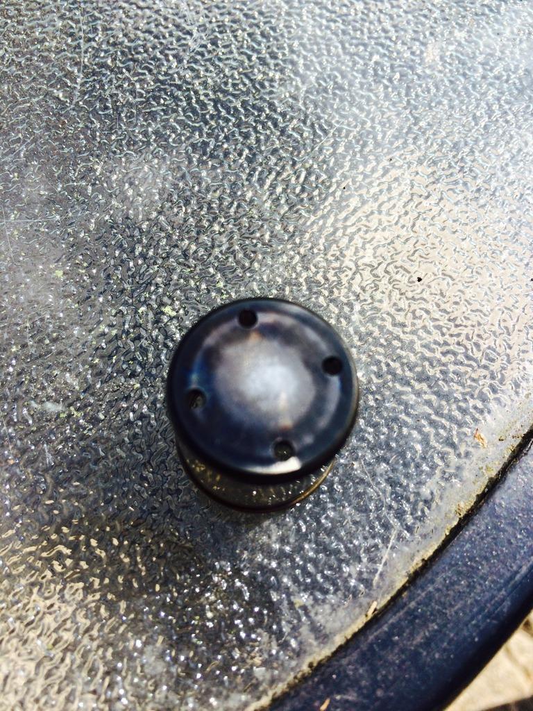

The wear on the original follower

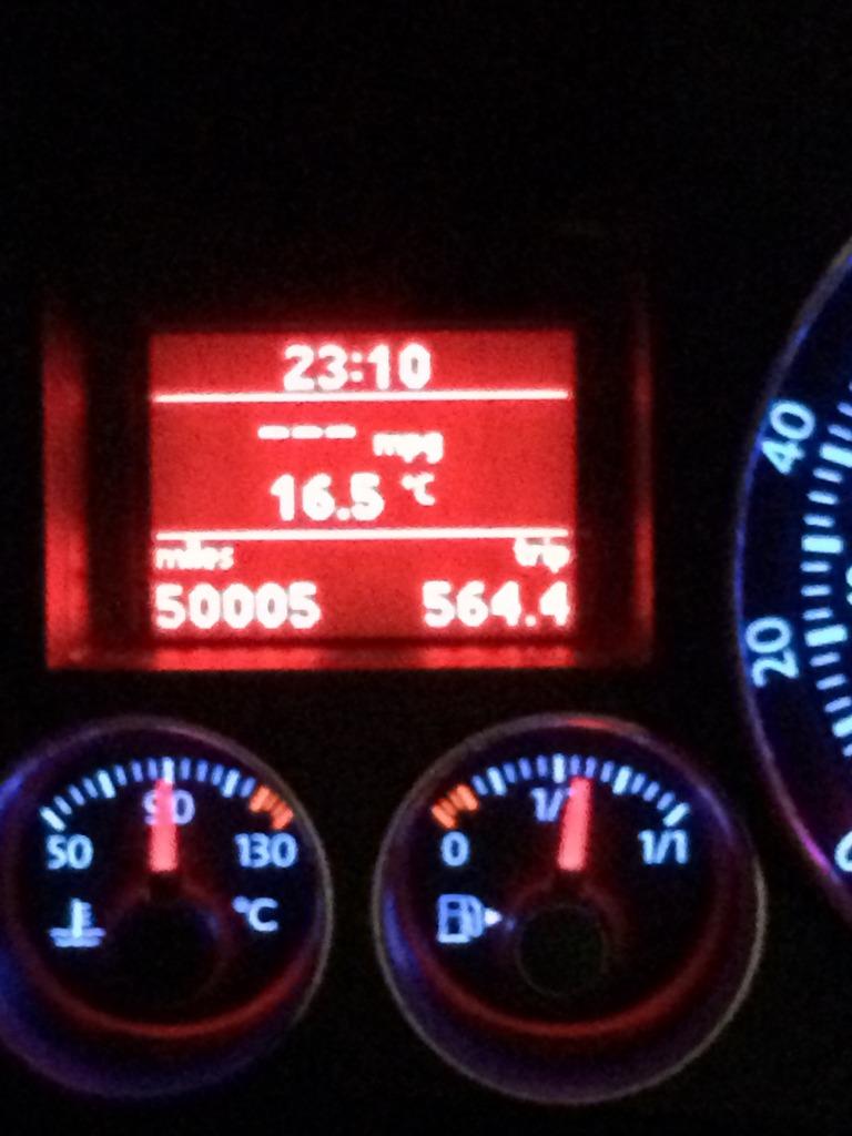

 rolled over the 50k milestone last night

Nice work  :happy2: not the worst cam follower I've seen but defo needed doing
Welcome to the over 50k club  :drinking:
