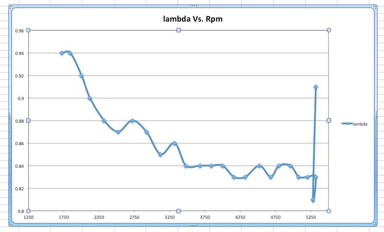

« Reply #51 on: August 26, 2016, 05:42:39 pm »
Pudding, what Lambda reading would be too lean?
2nd column is RPM Far right is Lambda
« Last Edit: August 26, 2016, 05:48:55 pm by Tfsi_Mike »

Got home about 15 mins ago. Gambled on the A614 and the ring road was indeed rammed.
Anyway. Big thanks to Tfsi_Mike for helping out with this. Proper gent. And the Cupra is a lovely in the flesh.
As predicted, no misfires, car performed very well. Let's see if some of you with more knowledge than me can spot anything!

« Reply #53 on: August 26, 2016, 07:37:52 pm »
Great to meet you Andrew.  Planned on taking the Cupra up the a52 so you could compare.  Traffic seemed to be building though.
Hope you get to the bottom if it, so frustrating.
Im going to see if I can graph som elf the date, just to make it a bit more visual.

Re: Spark plug gaps
« Reply #55 on: August 26, 2016, 07:49:12 pm »
Just attempting one on Excel, Im a bit rusty.
