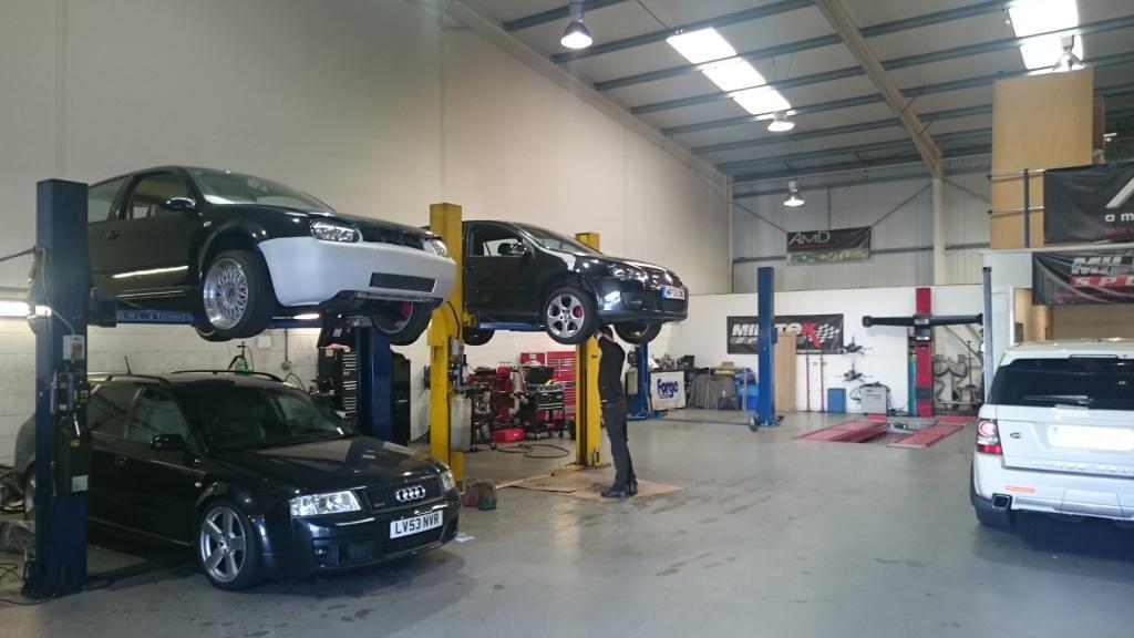

So yesterday I bit the bullet, phoned AMD Tuning and arranged to get a GFB diverter valve fitted today, the technician mentioned that on Saturday it was a first come, first served basis. So I got down there for opening time for 9am  :grin:

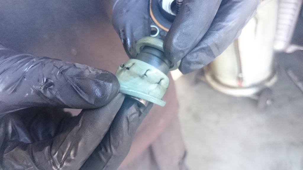

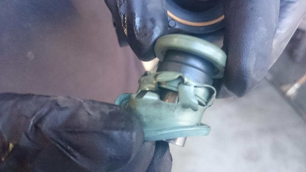

Within a few minutes of arriving my car was up in the air and the technician was busy taking the old part off.
The rubber valve was totally shot, it was literally in pieces! The chap @ AMD Tuning mentioned that you lose in the region of 30 bhp with a torn diverter valve according to previous tests on their dyno so its definitely worth checking. I only wish I had the required skills to change parts like this myself

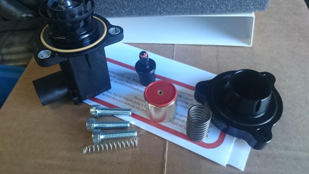

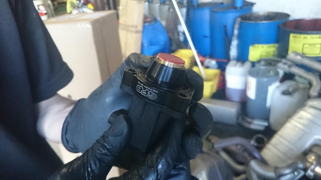

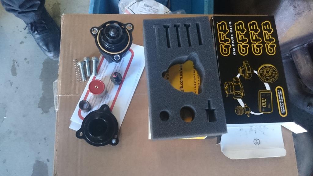

Here are some pics of what you get, you can see the piston style diverter valve as well for comparison

As for the performance difference well what I can say but WOW!!! The car actually takes off after 3,500rpm. I honestly cant believe the difference and I'm more than a little annoyed with myself for driving around for the last year or so with a car not running on full boost.
Without pointing out the obvious, You would have got the same gains by fitting a standard Revision G Diverter Valve! The improvement is not down to the GFB Diverter and more the fact your old one was totally ruined.
