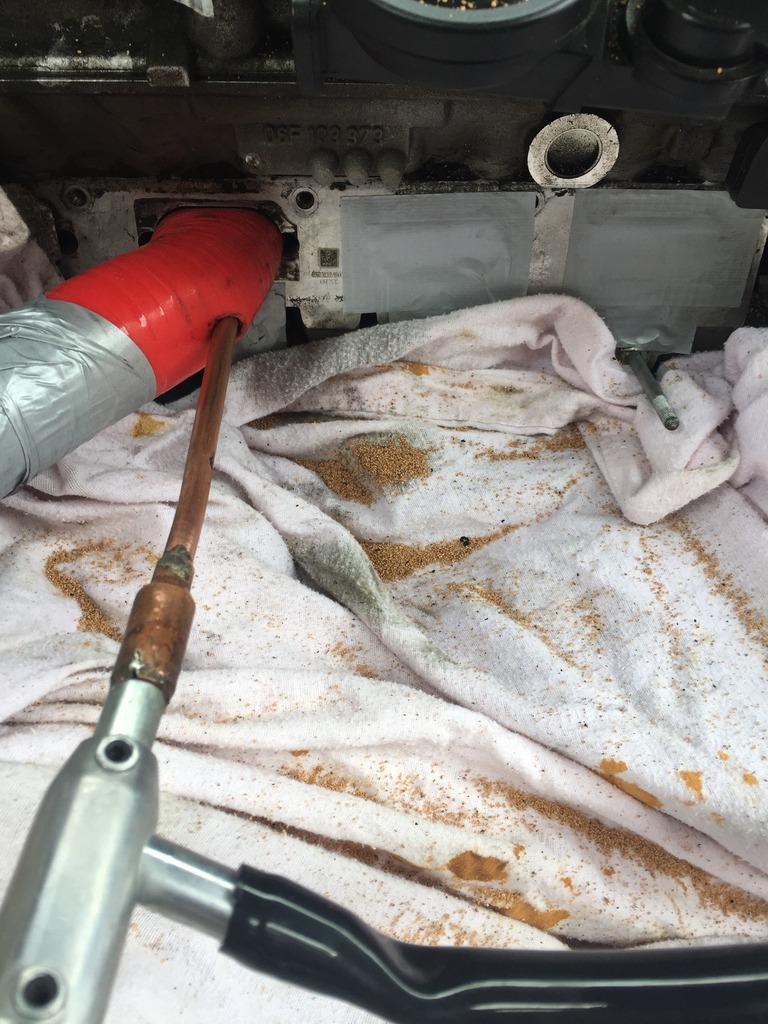

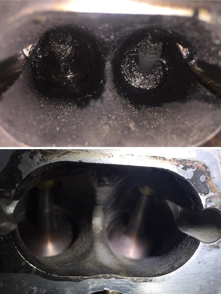

Did my valves today, i walnut blasted.

Great job @v4rley there almost gleaming  :happy2:

Cracking job there mate, what walnut blasting kit did you use if you don't mind me asking and can you feel any different

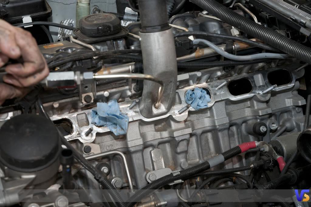

There's all manner of media blasting kits online mate.   BMW use a clever inlet port to connect a hoover to, which stops bits of walnut getting everywhere.  Not seen anything like that for VWs.  Not hard to make, so not sure why no one's done it yet.

@99hagued Not sure on difference, as did multiple tasks (rfd, rs4 valve, loba hpfp). brought a cheap blaster of eBay for £10 that fitted on a compressor line and adapted the end with some copper pipe also adapted a silicone hose:
@Pudding obviously can see my attempt at replicating the BMW kit. The BMW does fit our inlet to but are about £90 for the atttachment but not readily available in the U.K.  Someone in America has 3D printed versions for about £50
