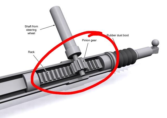

If it's all tight under the car could it be a worn steering rack

It seems like it could be something like this or the universal joint which I will be checking now I've discovered a little inspection cover I hadn't noticed before. It feels so close if you know what I mean and not just when the engine is running as I said before.

In stationary rock your steering wheel left to right and if play is evident you're either looking at replacing your inner track rods or your complete rack.
My rack rack inner rods had play so I replaced the complete rack myself.

Yes the play is there all the time engine on or off, im guessing its the full rack as vw and another garage said it was all solid underneath, its also an early 05 plate and  ive read alot they had rack issue's. How hard did you find it, did you have to plug car in to get coded? Think i will have to use next gen and do the loom bit to

been speaking to a mate and he says it must be the same issue as mine inner rod ends but I replaced the complete rack. I still haven't gone to VW to get it coded as it's not causing any issues TBH.

Ok cool Thanks for that, going to just do the whole rack and see what happens, cant be any worse tbh lol

Youll be fine mate, did mine and it sorted the play out straight away but you will need tracking after the replacement as the used one will be out as my left wheel was towing in by far and the right hand side was dead straight. Did it myself and it's bang on but will get it done properly once I've fitted the S3 wishbones, super pro ALK, H&R roll bars and full H&R springs and shock set up.
