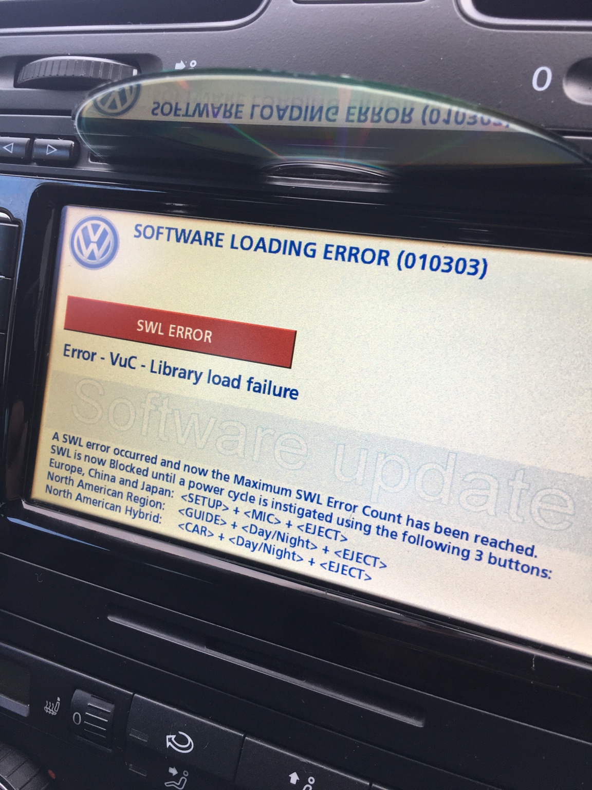

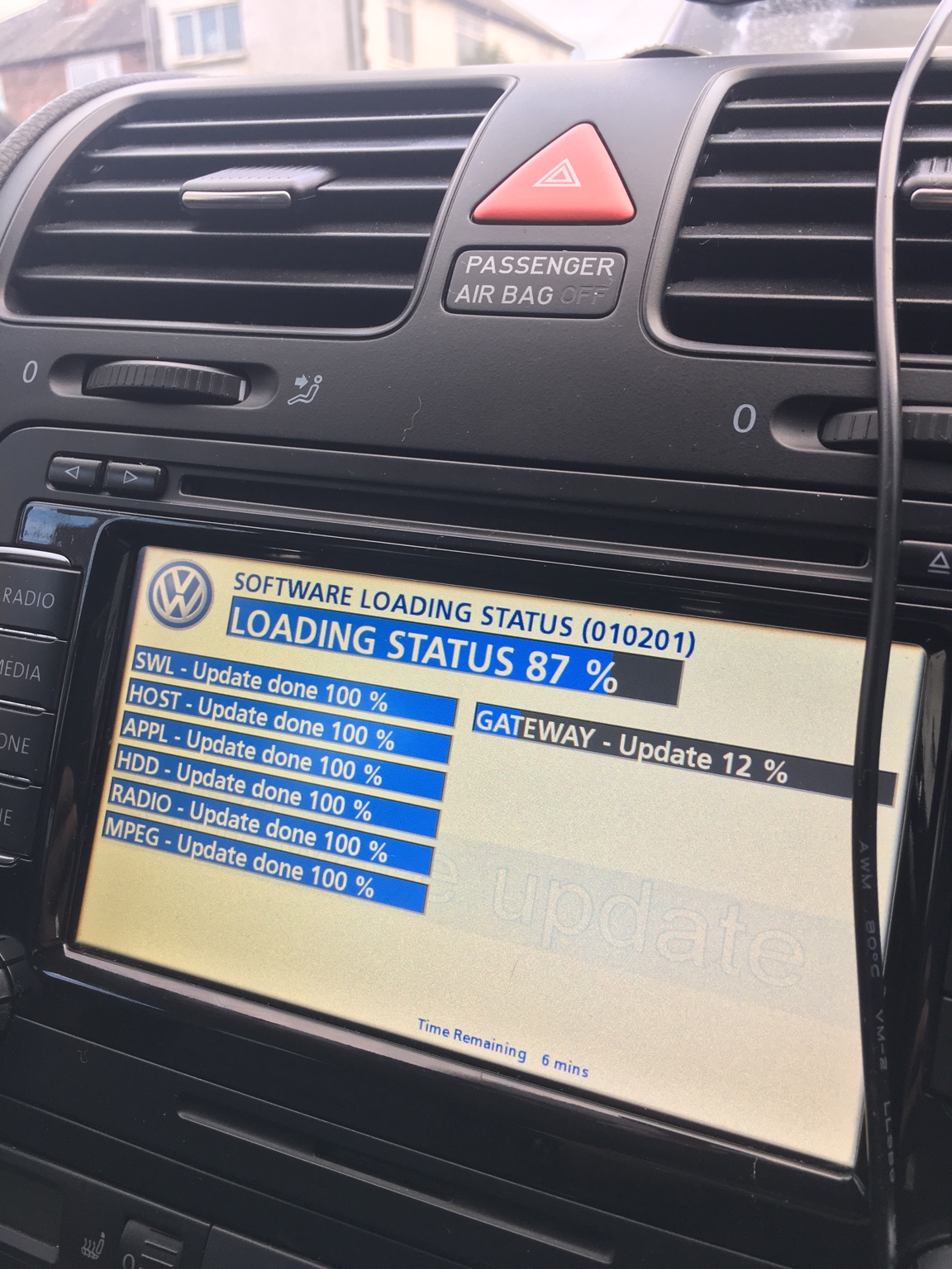

Keeps failing. All modules update 100% except gateway which gets to 12% then flicks to an error screen SWL error.. Have to reboot.

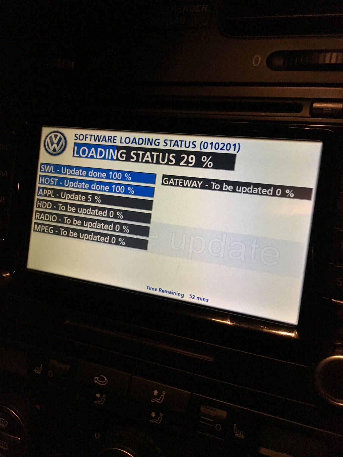

Gets to here ... Then ...
Using CD, won't recognize a DVD

Just done some research (here:
http://www.my-gti.com/3374/volkswagen-rns-510-firmware-upgrade-and-information
) and it looks like you need to use the recovery disc to get out of the SWL error

But it does boot, it just doesnt load the software correctly - every time ive tried I get a SWL error, on one of the components..
Ive tried CD and DVD, but I cant get a successful load! Its driving me insane!
