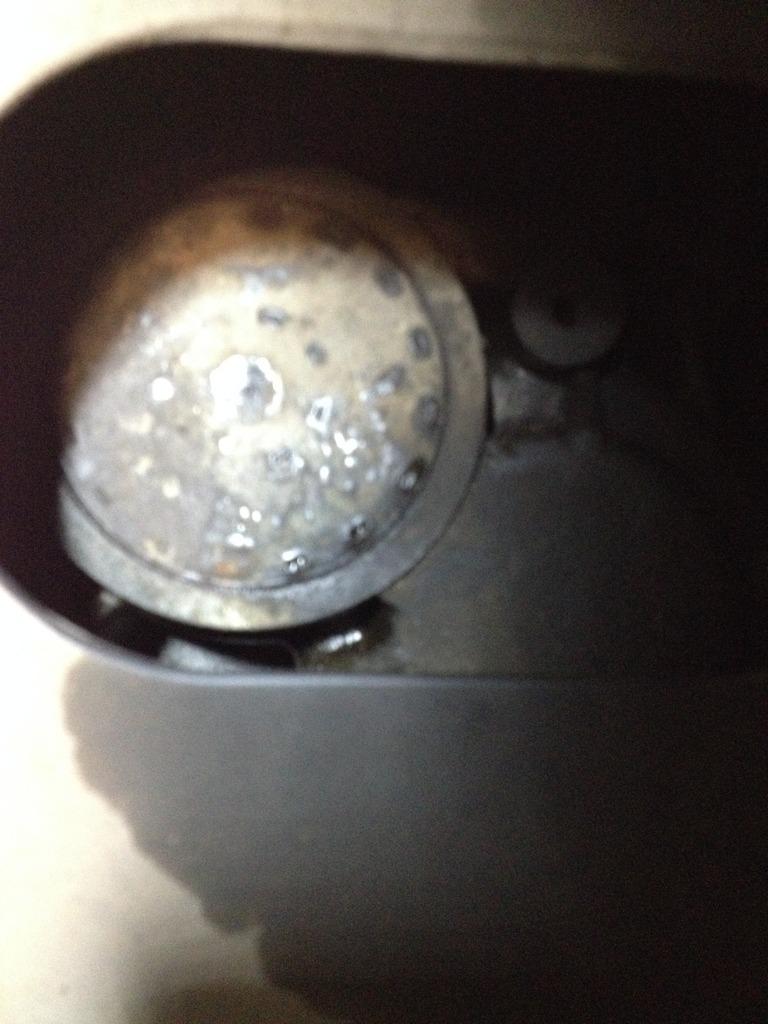

Got a small leak of gearbox oil. As you can see oil is dripping down and pooling around the plug however its source is actually from the side of the gearbox as you can see in the second picture. Can anyone shed any light on this for me? Why would it be leaking from here/what can i do about it? Should i be topping up the gearbox oil / is it dangerous for me to drive in the mean time.
The source:

You'll need a new bearing cover to stop that leak.  Pretty cheap from VW.  There are youtube videos on checking and shimming the gearshaft end float, which also covers removal and refitting of that round cover.
They don't normally leak, so maybe a previous owner has been in there before, possibly to check the shaft end float.
