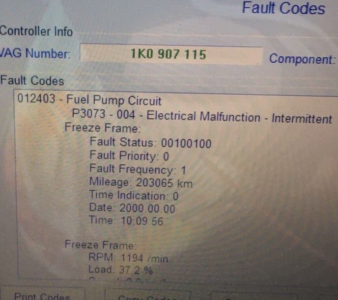

Hi I've googled these fault codes but I don't seem to be getting a answer to the problem just suggestions that it could be fuel pump or the module.
If anyone could shed some light would be much appreciated!
The car seems to be running fine with no issues and seems to be just as fast as my old GTI as I put them side to side, car starts fine, once I got a slight hesitation but nothing since that.
Anyway I can do some measuring blocks to see if the fuel pumps working how it should be?
Thanks everyone

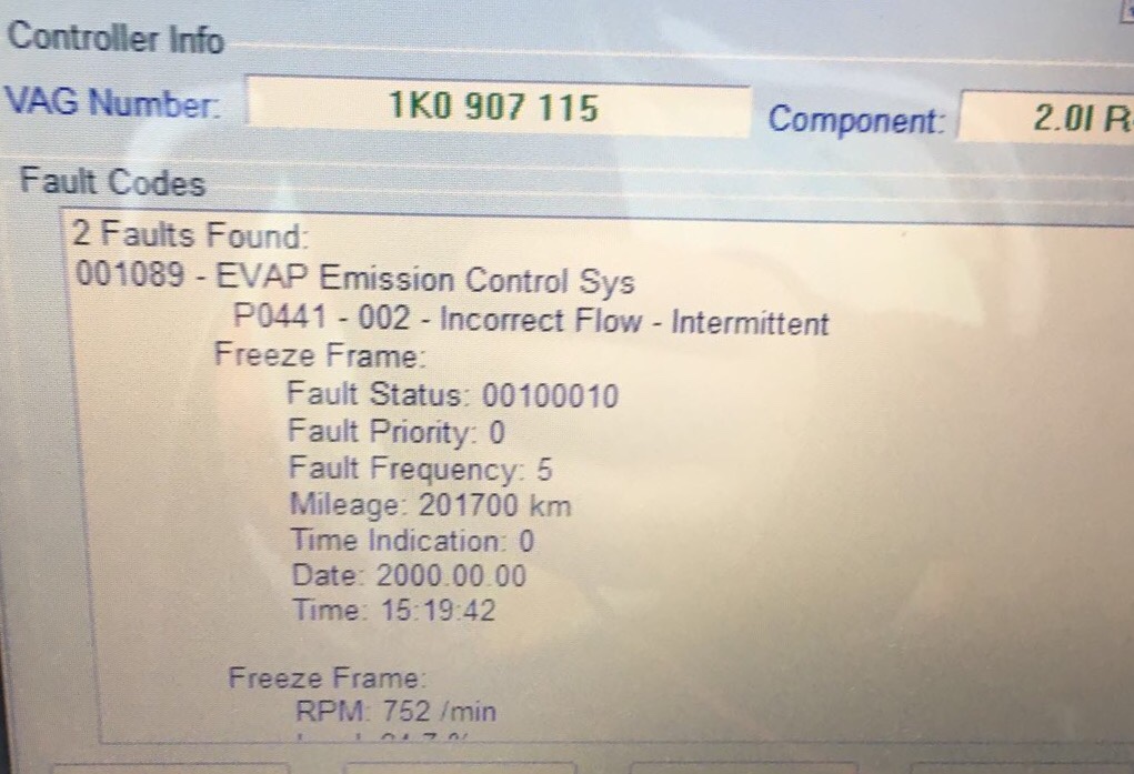

« Reply #1 on: January 08, 2017, 09:36:51 am »
Hello buddy the p0441 fault would suggest a problem with the N80 valve or failing that the charcoal canister. Not too sure about the other code but have a look at the attached link for a few checks on vcds
http://wiki.ross-tech.com/wiki/index.php/2.0l_TFSI_(AXX/BGB/BPJ/BPY/BWA)
Hope this helps  :happy2:
