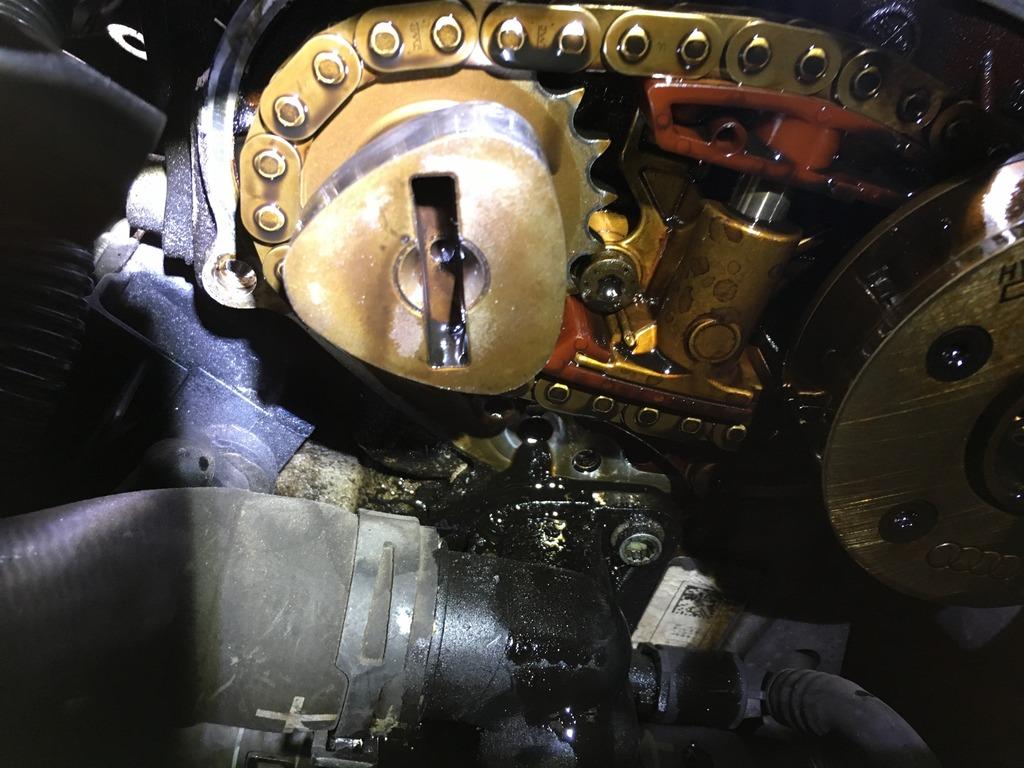

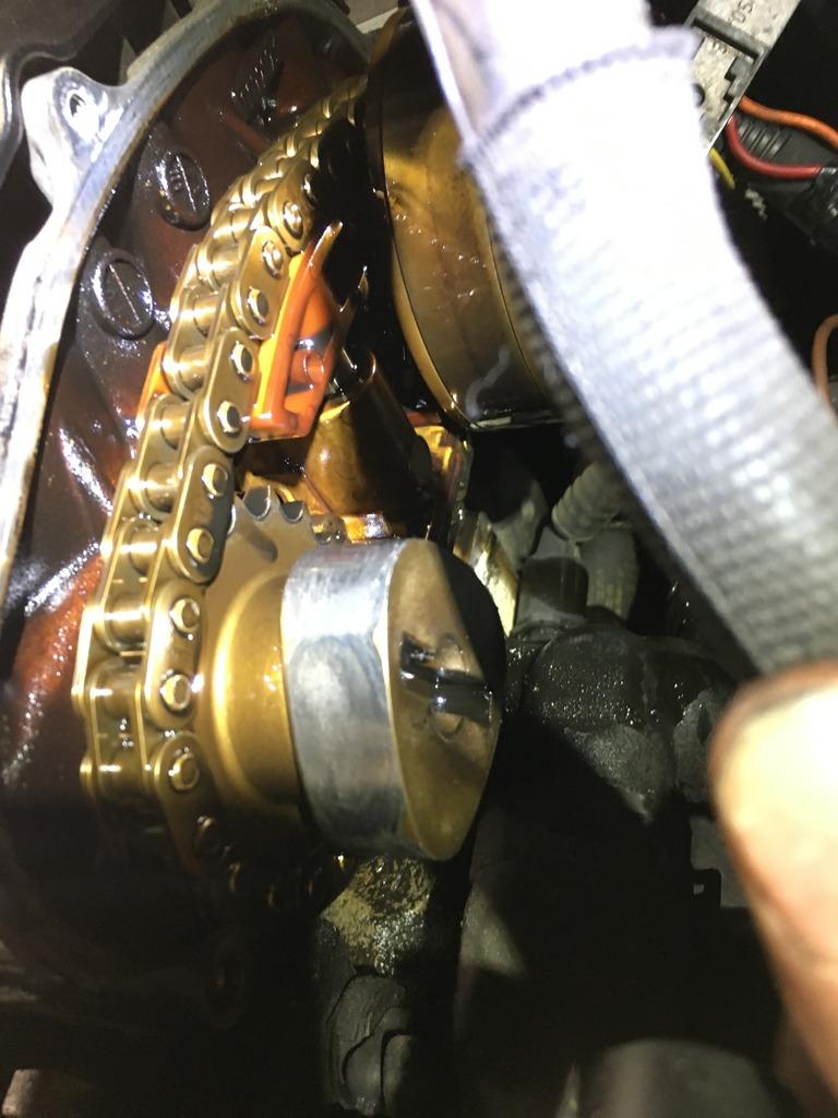

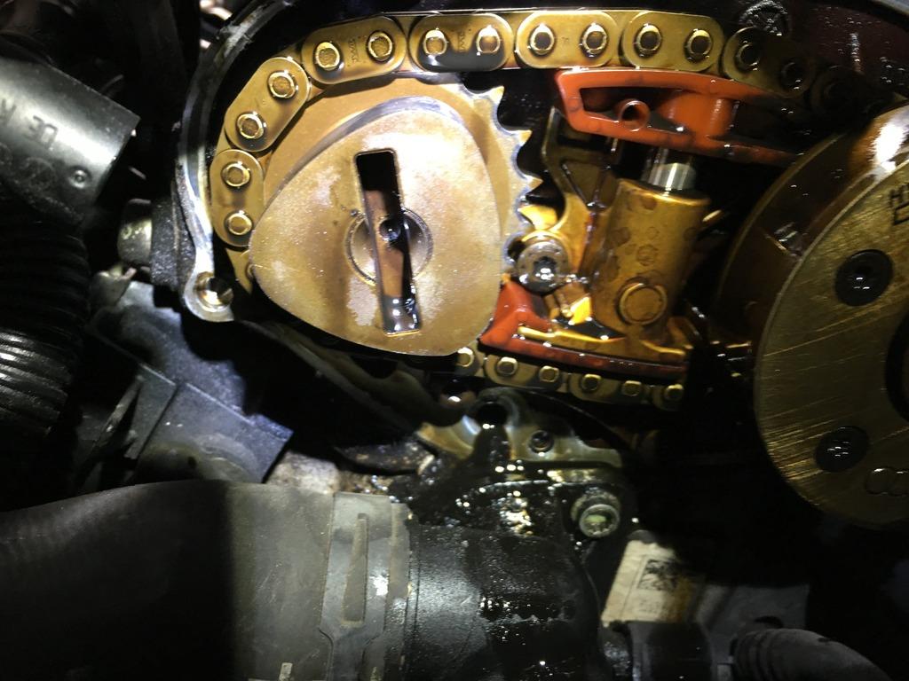

i removed the chain cover to day to replace the gasket as it was leaking slightly and i was wondering if my cam lobe is worn bad enough to change it here a some pictures, what do people think.

Yep... i would change that. Change it to the latest B revision.... thats the older A version.

Defo change too

IIRC you have to change the whole inlet shaft. Not a small job as you will need to do all the timing at both ends of the engine. That is a softer rev A inlet shaft compared to the rev B shaft. I take it that this is an early AXX engine? Rev B Inlet camshaft around £300 IIRC.
Is the wear we are looking at on the "corners" of the lobe? Perhaps looking at it on phone but cant really see where the wear is.
Was your cam follower in bad shape after a short time?
Won't cost me much as will do it at work at a weekend also might be getting a camshaft this weekend of a mate that has a spare B version also I changed my cam follower just over a 1.5years and it don't look that worn tbh so might change it anyway but no Mega rush at the minute
