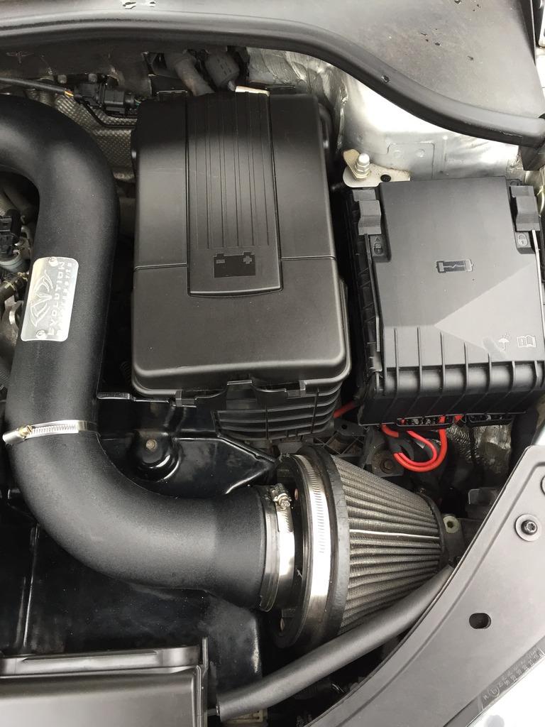

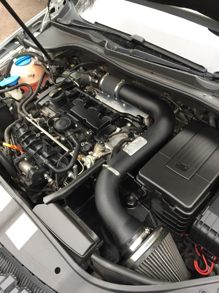

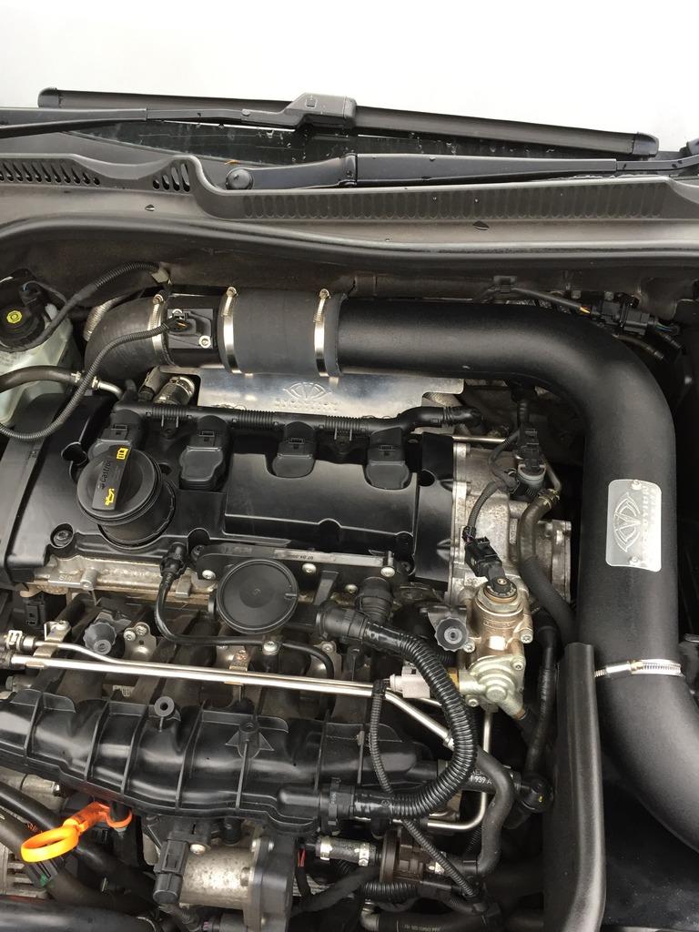

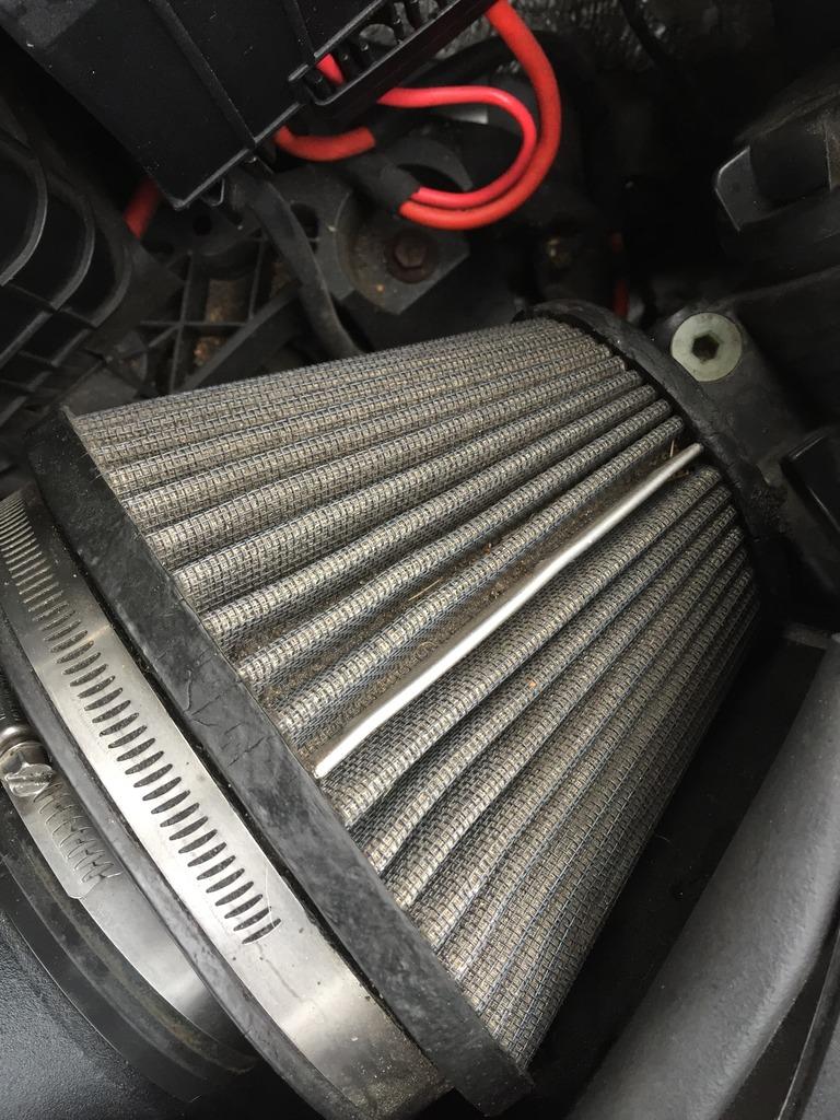

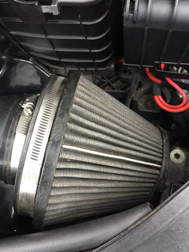

Hi all
I am soon to be doing a full service on my mk5 gti including cam follower, pcv valve and gasket, spark plugs along with the normal service parts.
My car had an evoms intake kit on it when I bought it, I have never had an induction kit before so is still quite new to me. I have tried looking at the options but I cant get a clear answer,
Do I just clean the filter out with cleaner and warm water and let it air dry or will I need to spray oil on it, i've found this kit so would this be all I need?
http://www.eurocarparts.com/ecp/p/-/-/-/-/?508771111&&cc5_9999
Heres some pictures of the intake
Thank you in advance
Jamie

That K&N is exactly what I use for mine.  :happy2:

Ahh perfect thank you Rich, from what I've read you just don't use too much oil on it after?
Thank you
Re: Cleaning EVOMS Air Filter
« Reply #3 on: January 31, 2017, 10:08:20 am »
Just follow the instructions. Can't remember exactly what it says but you want a uniform light red coating
Offline pudding
  • -Receive: 692
  • Posts: 8358
« Reply #4 on: January 31, 2017, 10:17:16 am »
Dab the excess oil off with kitchen towel or something if you over oil it.    And then after a week, pop the MAF out of the pipe and wipe it.  No red stains, no over oiling  :happy2:
