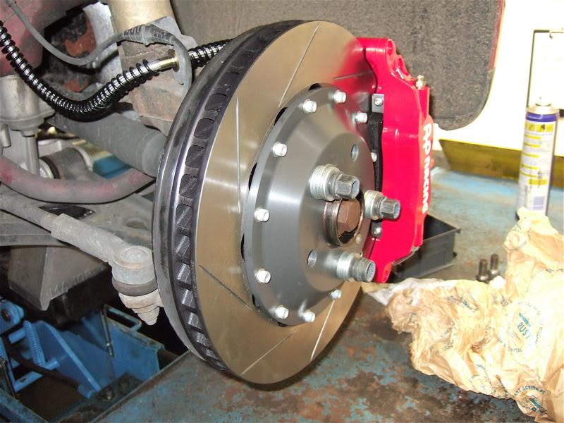

So the big question what the kind of budget needed for AP's or the Tarox??
....AP's cost about £1,700.
I would have bought VWR/RacingLine if I had known them then and if they had had their brakes available then, but I have absolutely no regrets and love my AP's.

How many more times are we gonna see that pic around the site Robin? Wearing a little thin now  :grin:
What about these then :innocent:
or the Porsche ones!

The 362mm discs and 6-pot AP Racing's finest I have en-route... drool!

AP's Senior Engineer reckons that their 6-pot is a bit overkill just for 'Fast Road' use. Expensive pads too.
Hurdy - I didn't realise your Tarox's 10's were all small pots - Their functionality you describe seems an excellent idea.

Discs on wrong hurdy LOL  :rolleye:  :wink:
