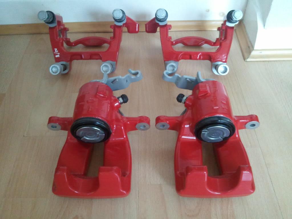

Just rebuilt these myself, not cheap or easy but had them powder coated in RAL3002 which i found is very close to OEM. These were from an R32.... i have replaced the following:new metal brake line pipes,bleed nipples,springs,seals and mounting bracket retaining bolts

They look just perfect  :drool:well done. more pics when you get them fitted please

Nice job, in fact very nice job. Rears are bloody tricky to get back together, the bits and pieces to assemble them such as the M12-M10 connecting hard pipe is about 15 quid with the VAT, the seals are a fortune from the stealers but are available aftermarket if anybody wants to take it on. The VAG seals come with a wetting agent to soak them in but brake fluid for an hour or two works just as well.
The other problem with doing these as a one off is the price of the VAG lithium grease for reassembly, it like buying a tube of toothpaste for £30 and cleaning your teeth once!
Red S3 rears are very definitely gucci at the moment - been asked for loads recently.
If I get a chance I'll get a "how to" done on the rears once and for all as they are not easy to do and if anybody felt like they wanted to give it a try it would be a good help.

I have a set purchased from SteveP sitting in my garage. The powdercoating was completely loose on one due to the dusty corrosion underneat (I could pick most of the coating off!) but intact on the other and the carriers so I am about to attack them with wire brushes etc. Otherwise dust boots etc. look good.
