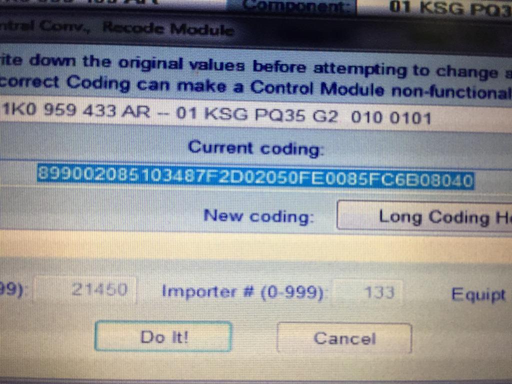

Just got myself a 1K0959433 "AR" module instead of my old "BT" one. This has a lot more bytes and options to it so I need to see someone else with this module installed in a 4 door  :chicken:
Can't get the rear doors to lock/unlock and the boot opens when I press unlock on the remote and I can't get the boot pop to work with the remote.
Any suggestions? :D

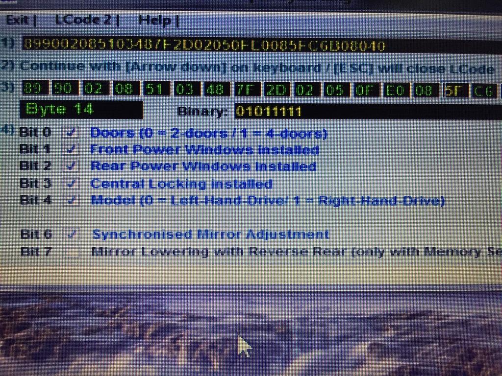

Yeah only know there 3dr as there loads on eBay and cheap unlike the 5dr ones. What do you want to see re coding?

Just wanted to see the code since I can't get my rear doors to lock and my boot either... Tried to copy the old coding from the old BL to the new AR and there a lot more bytes on the AR so some things are changed etc etc..

Ok bear with me a moment

« Reply #6 on: April 13, 2017, 08:48:58 pm »
^^im RHD fyi

Thanks. Got it fixed :)
