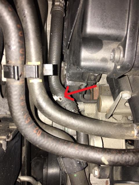

My coolant hose needs replacing, but Im not sure on the part or if I have the corect name for it, does any one know where I can either find the correct part number, or knows what it is.
Car  MK5/GTI/2.0TFSI/AXX
The part is near the cambelt.
Any thoughts would be great.

Is this the hose that connects to the hard pipe with a spring clip and then disappears around the back of the engine somewhere?
Why do you need to replace it?

I eventually found out what it is, its the Turbo Water Pipe, and I have item as well. the part number for future ref is 06f121492l
The pipe looks like it has a tear/corrosion, which you can just about see in the photos,  so needs replacing sooner than later.

« Reply #3 on: May 01, 2017, 08:47:01 am »
I just stumbled across it now so checked this thread and found you'd updated it.
https://shopdap.com/store/make-model-year/volkswagen/gti/mk5-2006-2009/engine/2-0-turbo-fsi/06f-121-492-l.html
Mine had a hole under the clip that was leaking coolant when the coolant was hot only. I trimmed about an inch off the end before realising that the end that goes over the hard pipe is enlarged.  (as per the photo in the link).Had a mongrel of a time pulling the cut end of the hose far enough onto the hard pipe so that I could secure it with a hose clamp.
At least I fixed my coolant leak though.  :grin:
