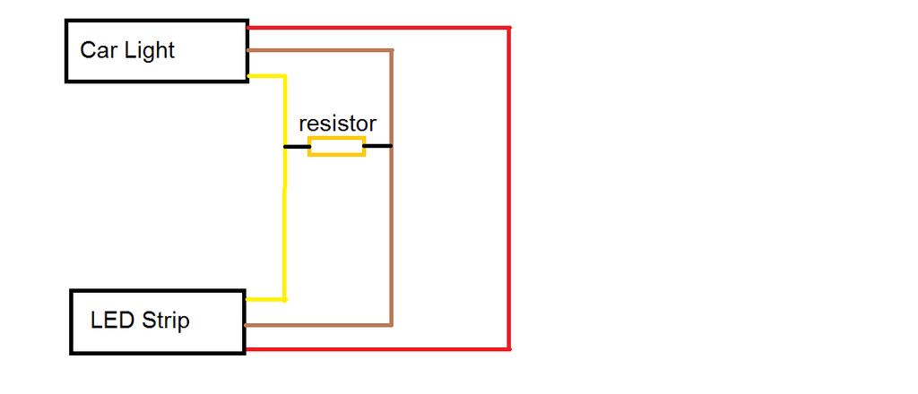

Right so I have installed some LED strips on my headlights with Indicator Sweep and DRL Switchback but left with one issue I am unsure how to solve.
I have wired the lights up as below in the diagram and there are no bulb errors and the indicator sweep works and so does the DRL when the car engine is off and key turned.
However when I switch the engine on everything works still apart from the below 2 issues which I am thinking are one in the same
1. When DRL on you can see the odd Indicator LED flicking on and off
2. When press the Indicator on (even with DRL off or on) you can see the DRL LED's flickering on while the Indicator is sweeping
The resistor hooked up is a 25W 6 Ohm which I worked out is what it needs.
