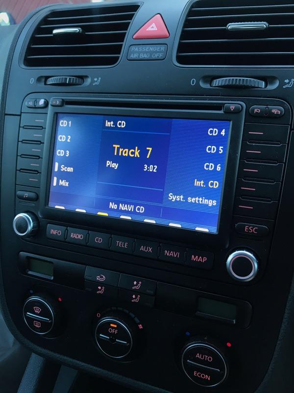

Wondering if anyone cold help/advise.
I've just bought a 2005 GTI and it has this installed with a 6 disc changer in the armrest although that throws up an error and will not work.
I'd like to change it for something (VW preferable) that would except a SD card and poss phone connection although not sure if I'd have to install a microphone??
If someone could advise that'd be great

RNS315 is the obvious upgrade from there.  You should get a DAB one for around £300.  Has built in Bluetooth, so that's a bonus.  Should do everything you are looking for.
Alternatively, RNS510.  It's the top one, but doesn't have BT.  You need a new one for DAB too, so around £400.  For BT you can either go for a Fiscon or Parrot.  OEM is too expensive usually.
Either way, you will likely need a new CAN Gateway.  Usually around £50 coded, or you can pick them up for £30 or so on ebay and code yourself.
If you are happy enough with the nav system (easy enough to upgrade firmware, apply "crack" and burn latest maps), you could just add a Parrot system, letting you get your BT, USB, SD + Ipod.
