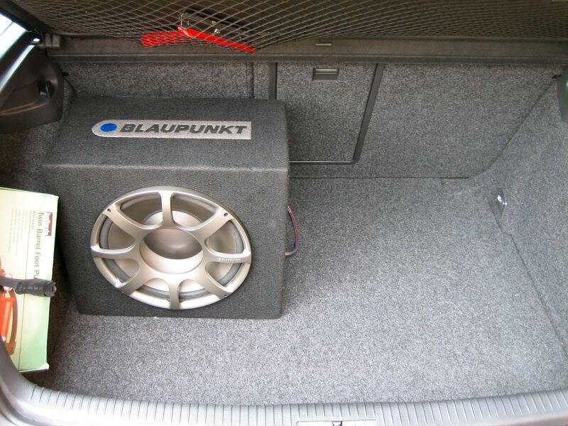

I'm running a Blaupunkt THA555 PnP five channel power amplifier with a 12" sub in mine and it sounds superb.  Actually one of the best mods ive done.  See here: http://www.bluespot.co.uk/stock/amplifier_4.asp
Not cheap, but if like me you just like things to work, it's well worth the money.
Some pics

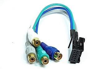

Ok bought one of these from Sextons Direct and got round to fitting it yesterday.
Got me a switched live from this guide here:
http://www.golfgtiforum.co.uk/index.php?topic=40936.0
The amp power ups fine using the switched live so all is good there. However there is no sound from the sub, well it buzzes quietly. I checked the RCA and tried different ones still no joy, so got me thinking is the lead the right one??

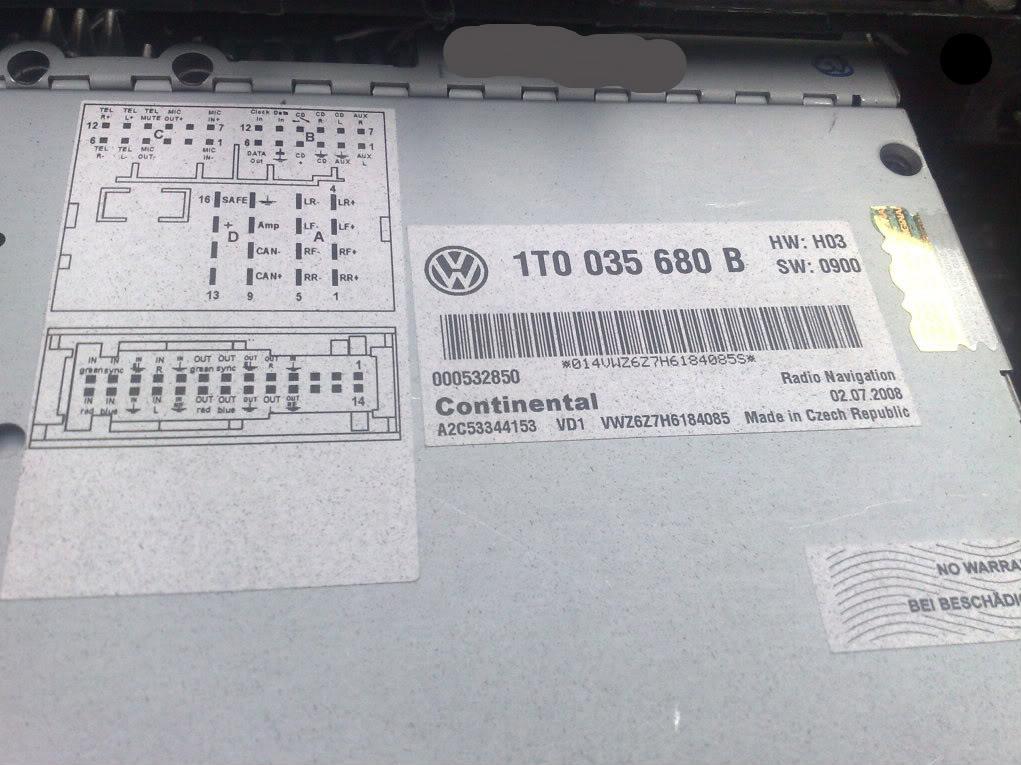

If you look at the wiring info on the back of the RNS
(Monte I used your photo from another thread hope thats ok?)
You can see that the pins to which the Line Out Convertor is attached refers to "Mic in"  and "Mic Out" this surely can't be right. Anyone got any ideas as  want to put the car back together??

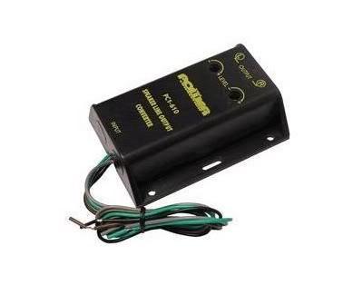

Ok so the part in my post is definnately will not give you a line out signal for your amp / sub, that part will give you a line into the RNS only.
The part you need is this:
Autoleads PC1 610
I also used a SOT harness (similar to McLovin's thread) as well which is basically an extension cable for the car's original harness which you can tap into rather than the cars wiring so when you want to remove no one knows you've tocuhed it.
And hey presto I've now got a sub and amp connected to my RNS510. Nice.
