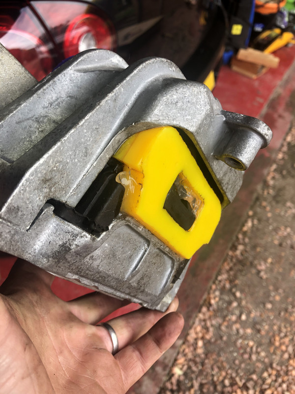

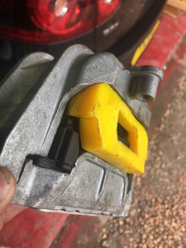

This theory was apparently true on the road after a bit of midrange acceleration. The car abruptly kicked to the right.  I got back home and found this:
As I suspected, the opposing force of the transmission side forced the engine mount insert out.

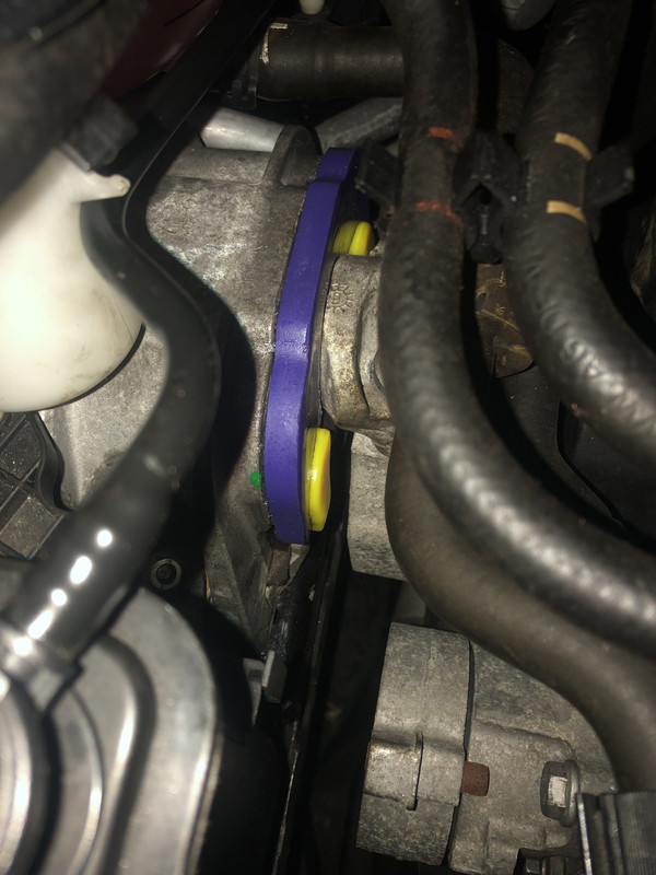

So to solve this problem, I did this:
I also had to shorten the main insert legs as they pressed hard against the engine side bracket, preventing them from going fully in.  The securing tangs therefore had to be cut off, but the 2 x M6 bolts keep the upper insert in place, so it's not a problem.
This remedial action shouldn't be necessary, but hey, it's only a 30 quid mod and the reinforcements do the trick  :happy2:

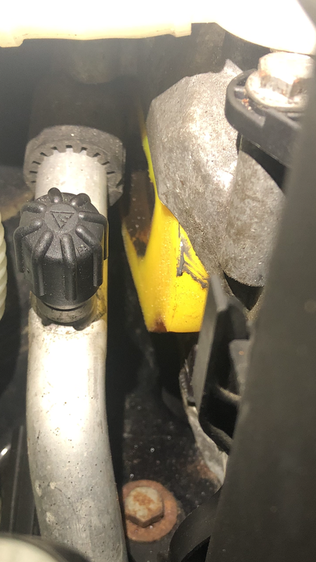

I haven't checked the gearbox side yet as it's under the battery, so not easy to see without a wifi borescope camera thing but I suspect it will be fine due to the reasons above.  If the inserts have walked out, I will apply the same measures.
You can clearly see in this pic how far off the bolt holes are when the mount is restored back to it's correct position with the inserts!  The gearbox mount is the worst one for wear and NVH.

I noticed the same thing happening on my drivers mount with it squeezing the inserts out...
They were fitted over a year ago and noticed it early in the summer so i removed the inserts, refitted them and pumped in a bit of clear silicone in places to hold them in place and have been keeping an eye on it and so far so good.

Good stuff, glad the silicon is holding  :happy2:  I think my 6mm steel plate to hold the insert in is a bit overkill but the insert is going nowhere!

Looks like i talked too soon as checked again today and it has squeezed out again.Going to devise something like you have
Looking at it now i was daft to think silicone would hold it in place lol
