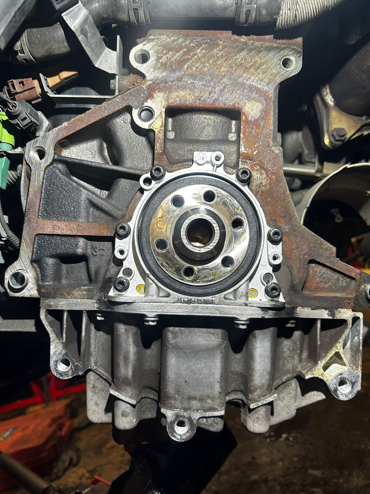

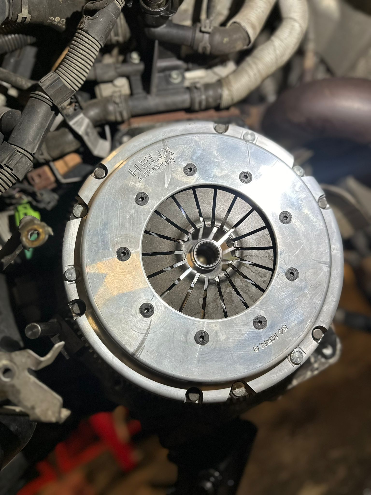

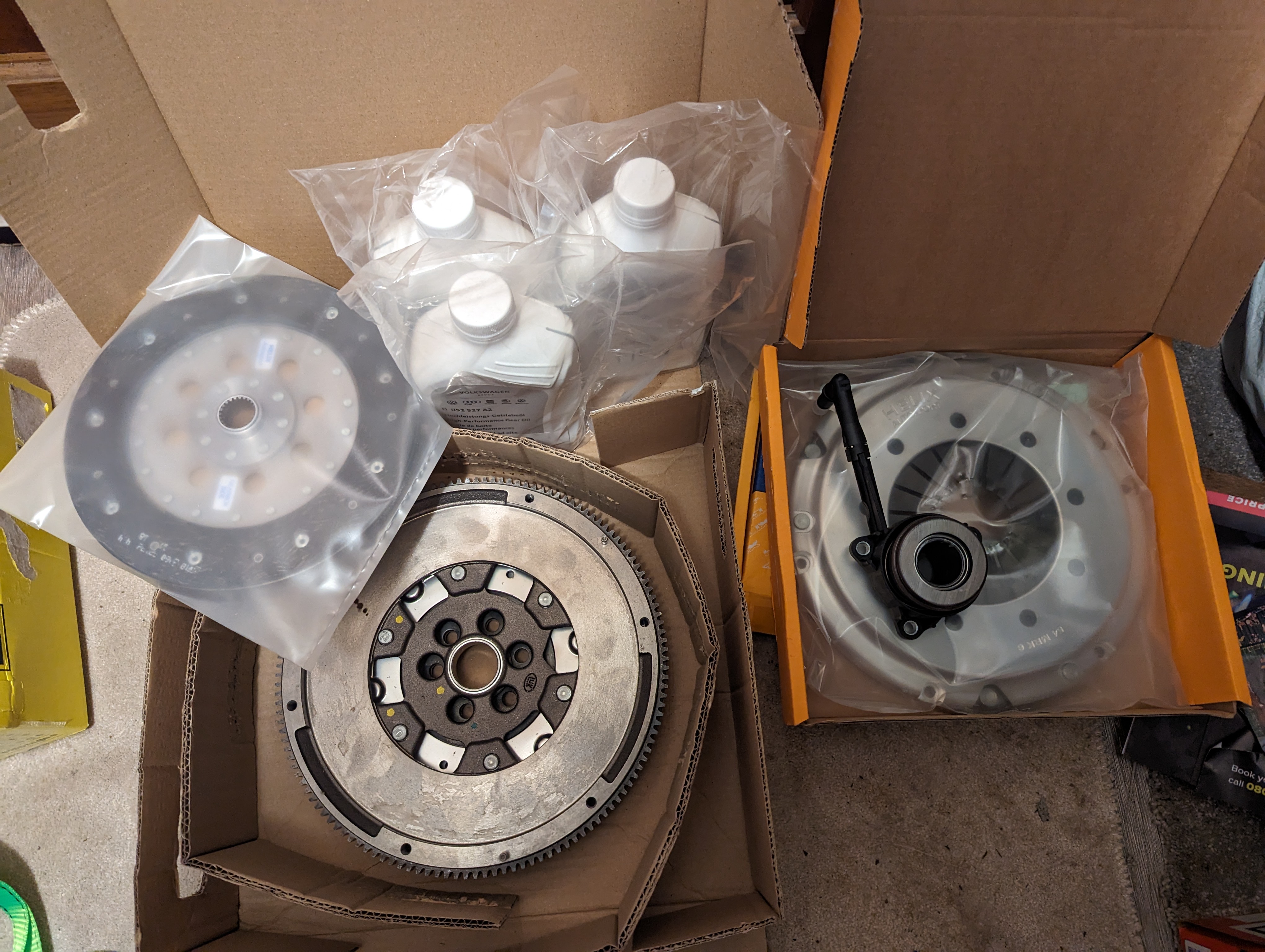

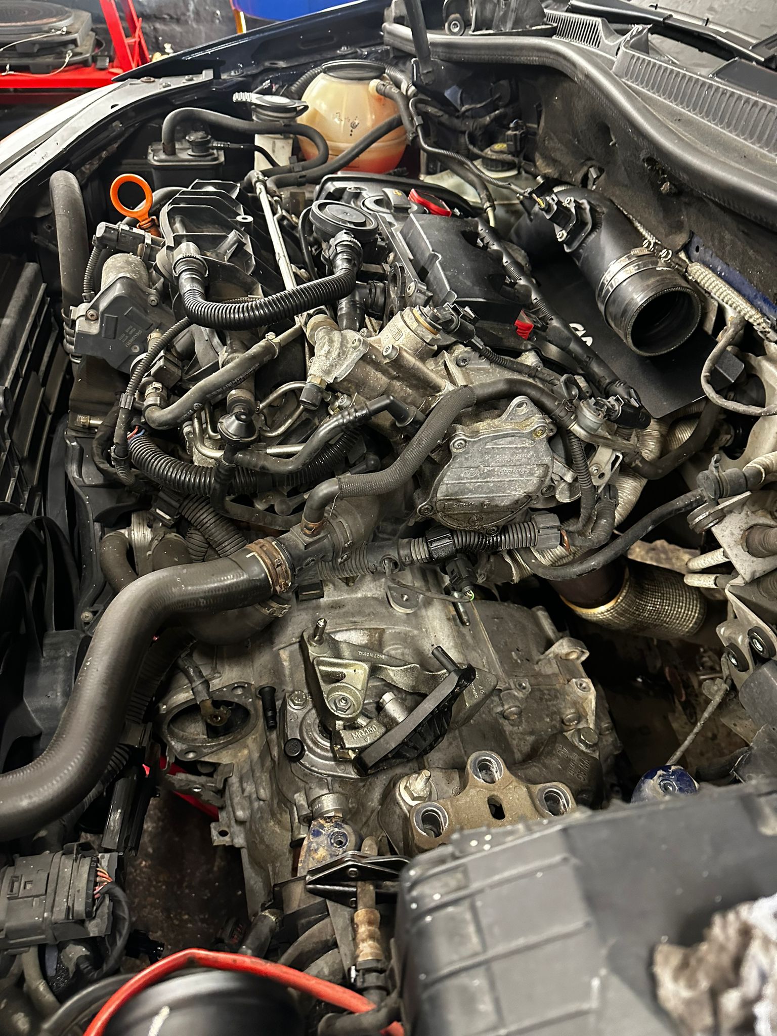

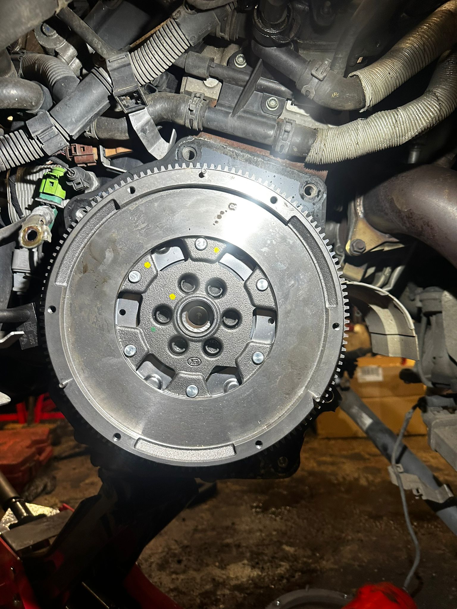

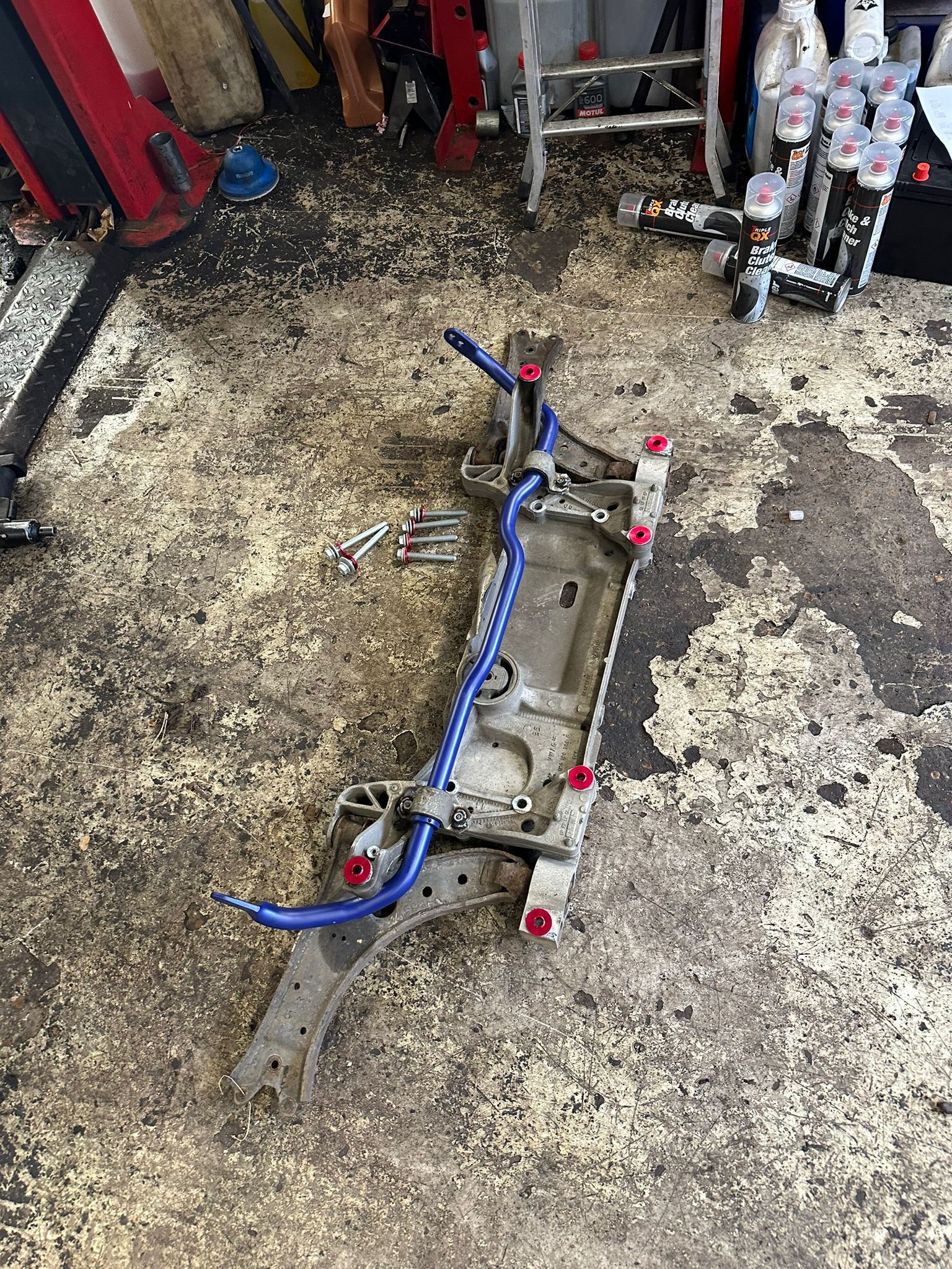

Finally got round to getting the clutch and gearbox fitted as well as a new cam belt and water pump.
Cambelt and water pump
Scirocco gearbox, 02Q KZS, 44,775 km (27,822 miles) from Netherlands
Helix clutch
LUK flywheel
H&R Anti-roll bar front
TRW Front drop links
4 wheel alignment
Pics arnt mine they're from the garage.
Was suggested that as the subframes off to install a dead set kit and also a new crank seal whilst the gearbox is off.
They pointed out timing chain gasket leaking so I asked for just the gasket to be replaced for now. Also said that a slight ticking on start means I should get a new chain at some point, also rear subframe bushes need replacing. All in all, very pleased.
