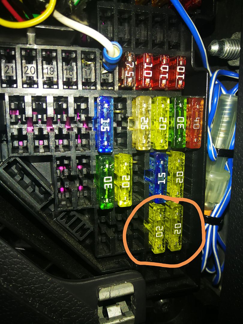

I have an issue with my fuse 41 and 42. It just suddenly has no power supply to it.
So basically the 2 x 12v sockets are dead and the wiper jets don't work. Wipers still work only no spray.

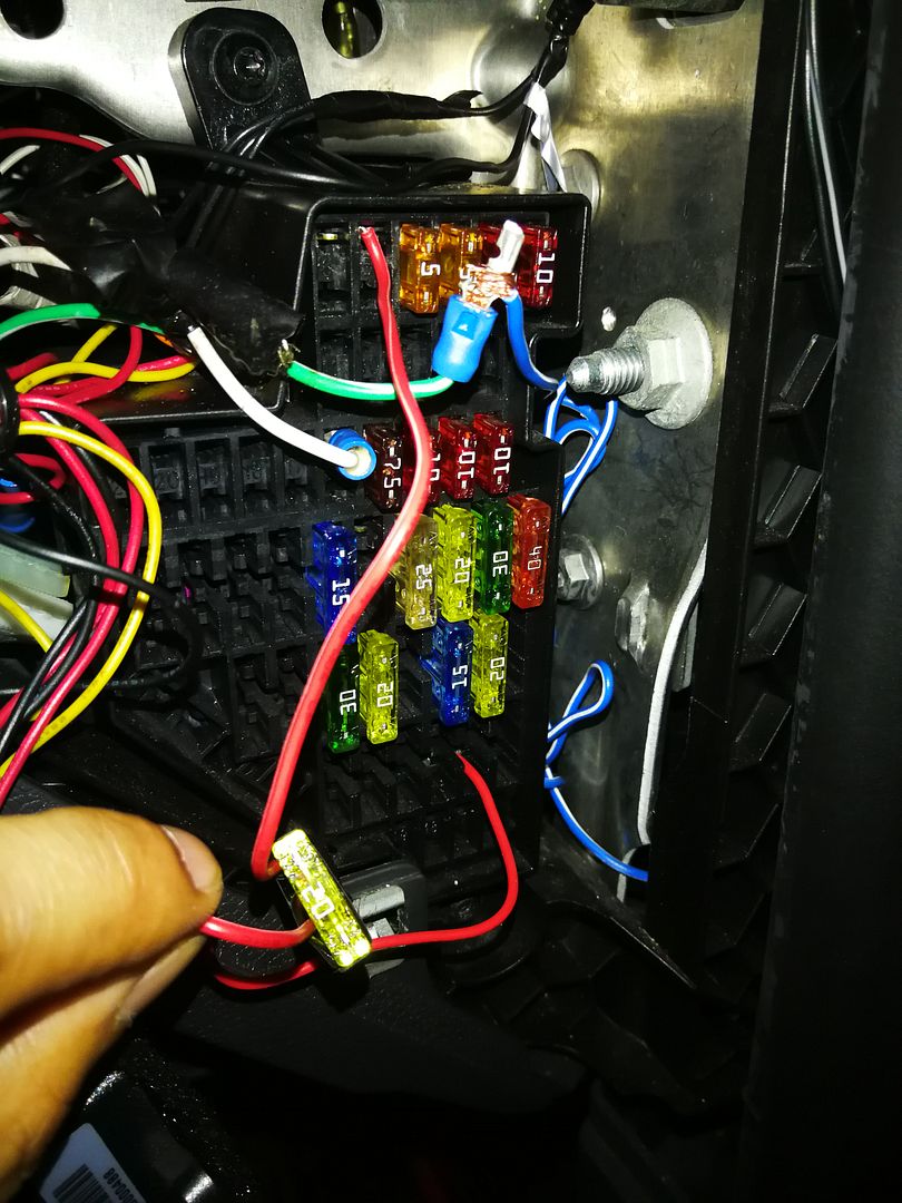

I have tried connection power from another fuse location and it actually made the sockets work when I tap to fuse 42. And the wiper spray works when I do it to fuse 41

Fuse 41 and 42
Tap power from another location.

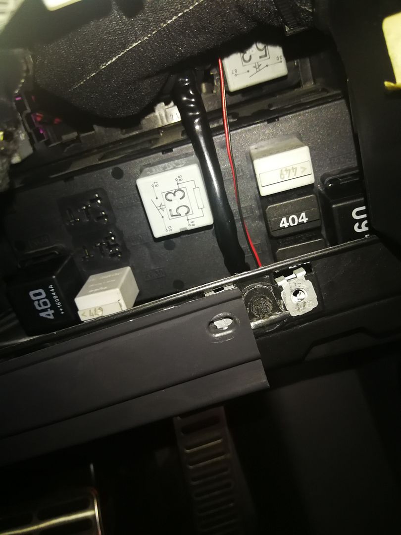

J519 relay board. Swapped the left and right relay 460 and still same.

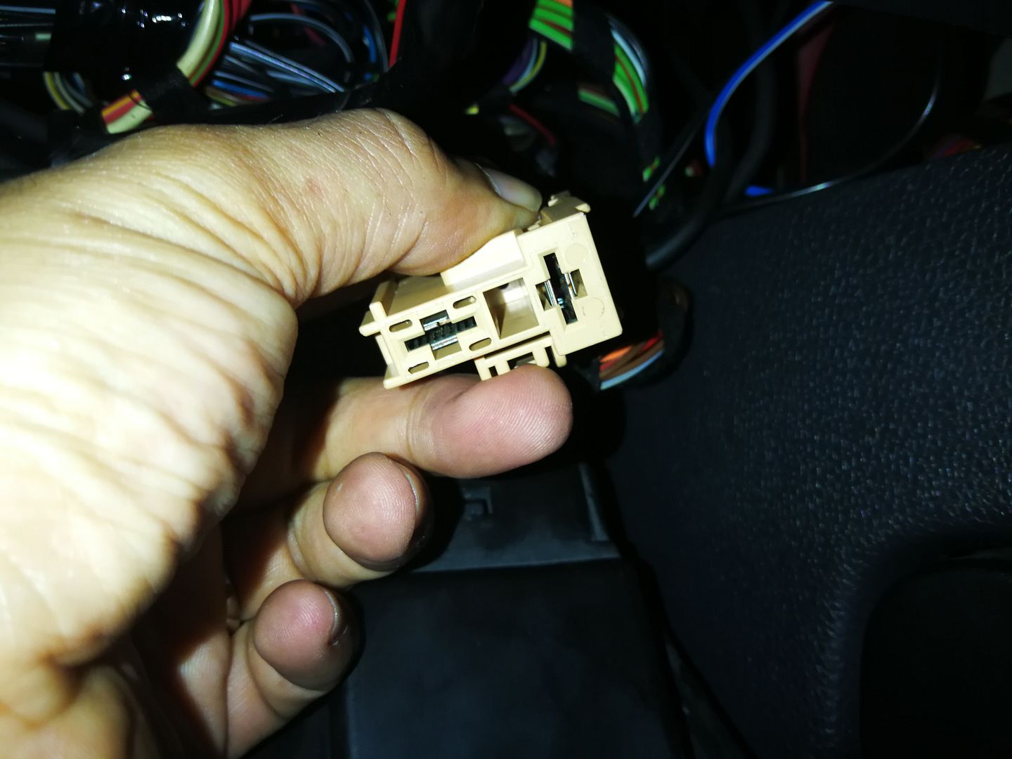

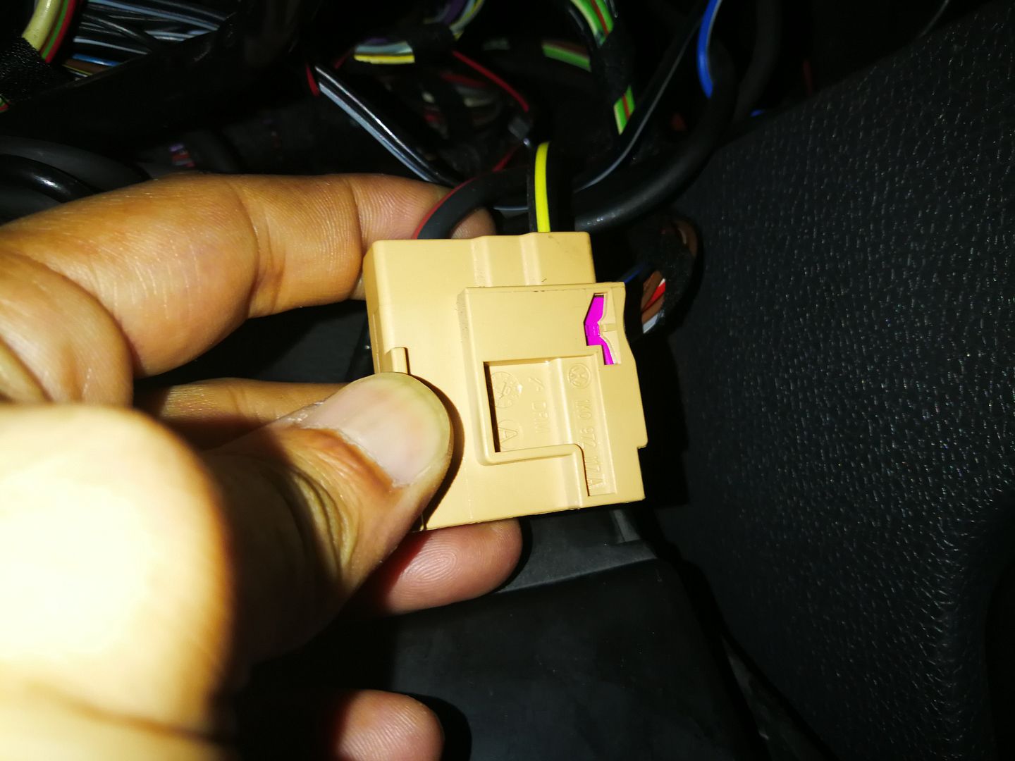

The socket that goes behind relay J59. Looks fine. I am waiting to get a multimeter to test if there is power supply from the red/Black cable. Apparently a user from the US forum told me this is the power supply to fuse 41 and 42. No rust there too.
Just looked at Haynes manual - it shows J59 relay does power to those fuses
First check J59 is getting power with multi meter or test light.
if it does -  you could remove the relay and try a jumper wire to see if this restores power to washer and lighter outlets- to confirm if the relay is the problem
