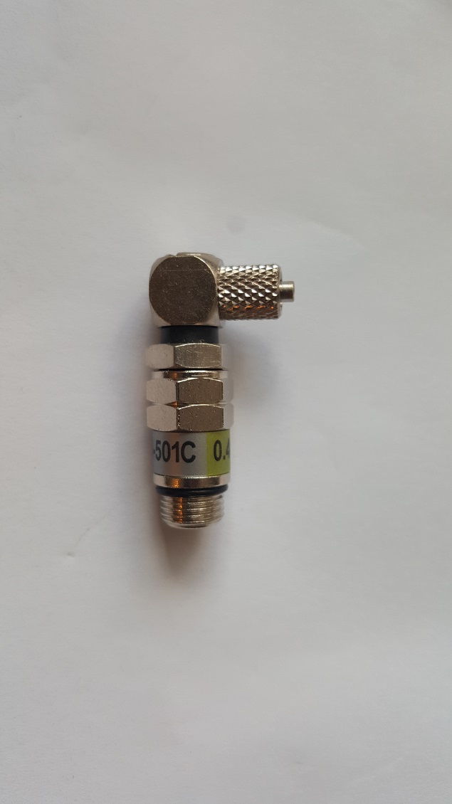

Aquamist 4-way hex manifold:

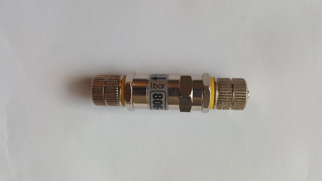

Aquamist 1bar Checkvalve with compression fittings:
Aquamist 140cc Checkvalve jet(I will running 4x140cc in intake manifold) with 90°compress fitting:

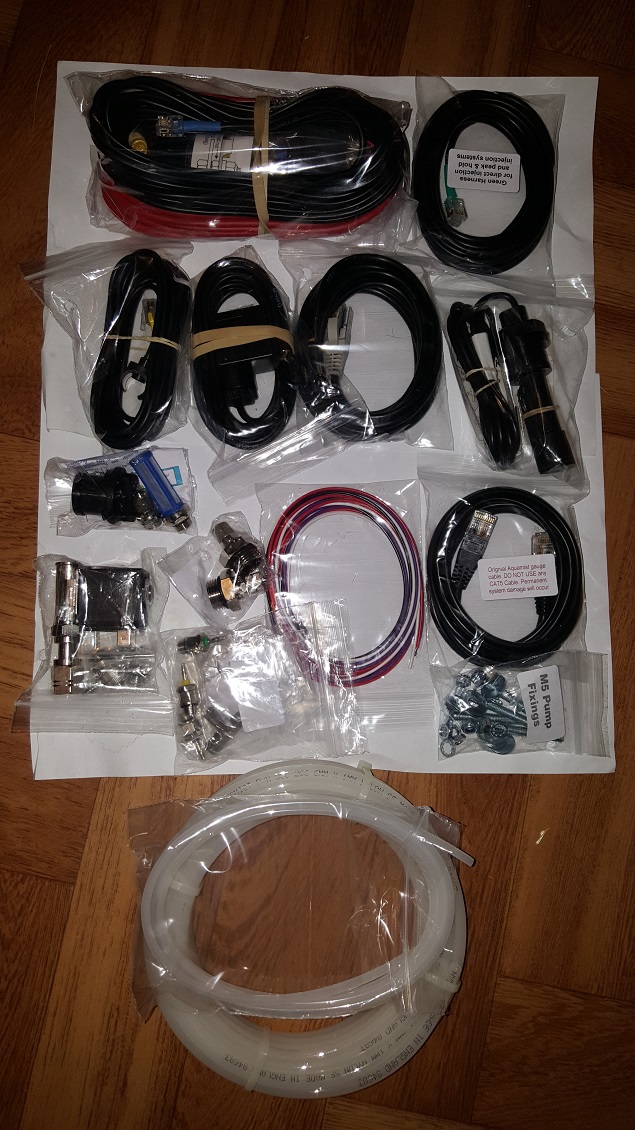

Few days before I start with summer vacations Im receive Aquamist HFS4 kit:
WMI pump:
Gauge installed into OSIR O-Pod Mono:
HFS 4 controller:

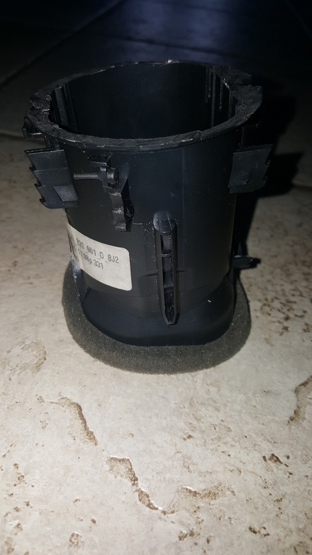

Because of design of dashboard air vent Im cut original to block airflow of vent which I use for gauge. Now I don't lose cooling efect on other dashboard vents ...
Blocked hole:
Gauge mounted:

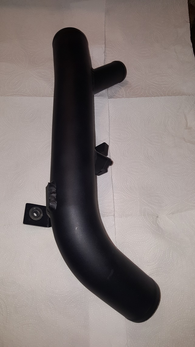

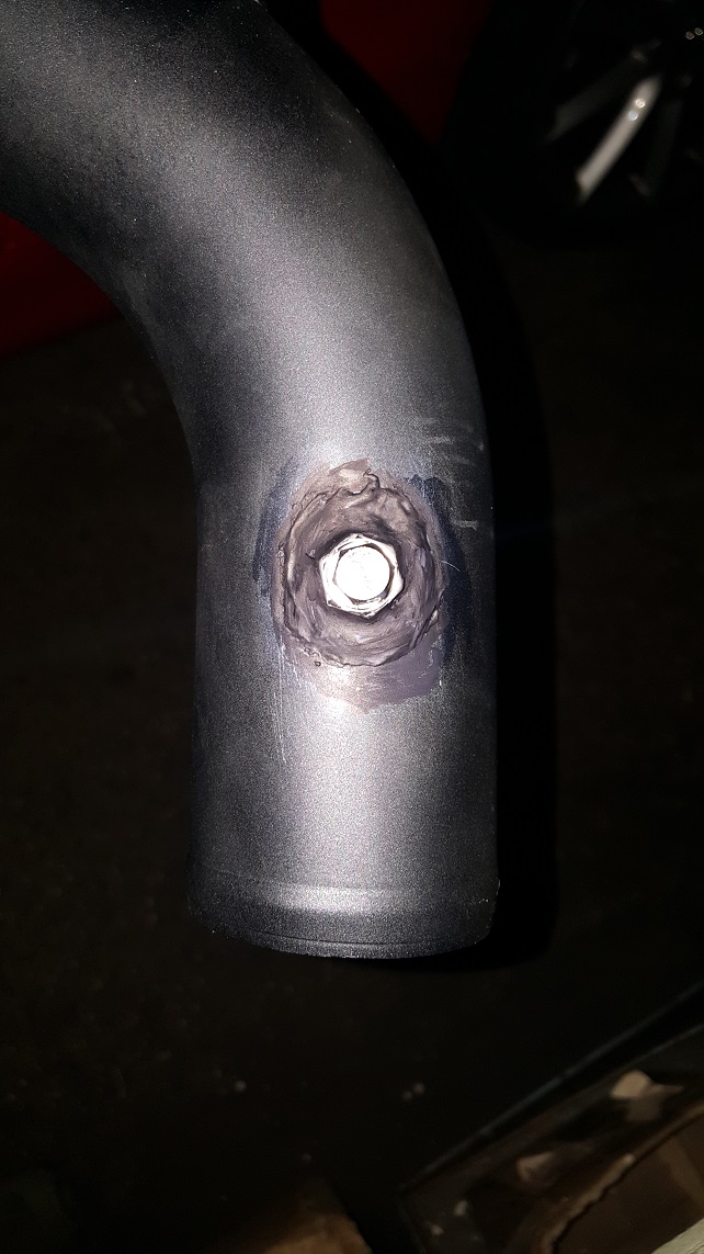

First Im modify Spulen throttle pipe pipe and add adapter for WMI jet:

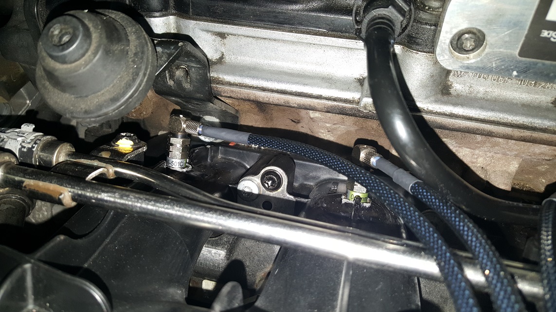

Then Im remove intake manifold and install modified one:
After that Im start installing HFS-4 kit.
First Im modify original washer fluid reservoir:
Then Im prepare case for wmi pump and relay:
Connect everything together(hoses, wires to ECU):
