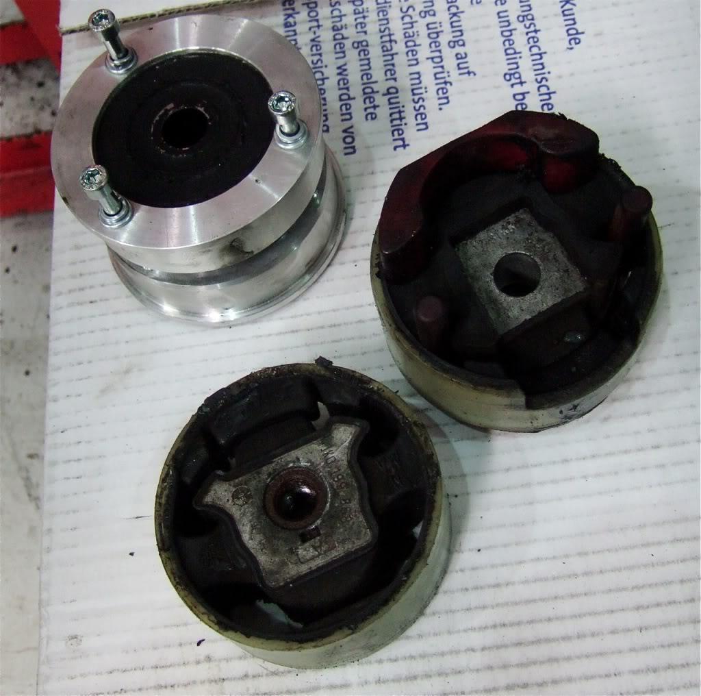

....Without delving into loads of paperwork and doing mathematics, I reckon something over 30k miles. Sorry if this is off topic but here's a pic of my Neuspeed Torque Arm Insert mashed when it was taken out : -
^ The upper left item is the VWR 'Fast Road' Lower Engine Mount. Their 'Race' one which Mat has is solid.

Robin, Whats the third lower left mount in the photo then??
its the top half of the neuspeed insert base thingy. I didnt notice anything from the powerflex insert either, now running with solid vwr mount but gonna swap for fast road one when clutch gets done, the Seat plastic fantastic interior is taking a beating :signLOL:.

One of my mounts broke once upon a time (reported a while ago when it happened :wink:) : -
