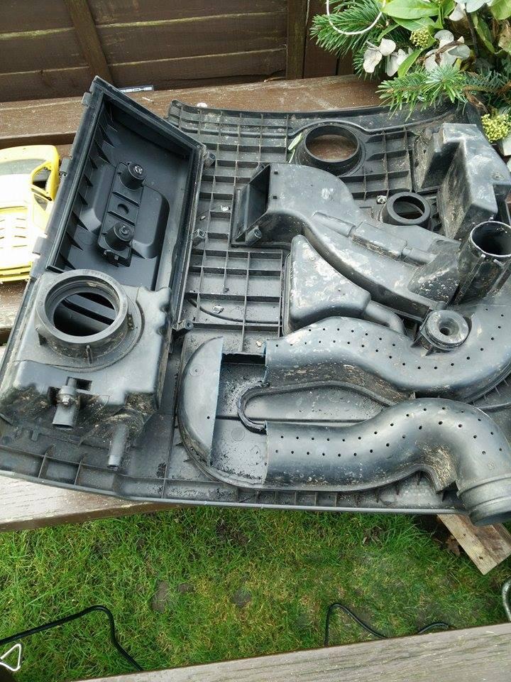

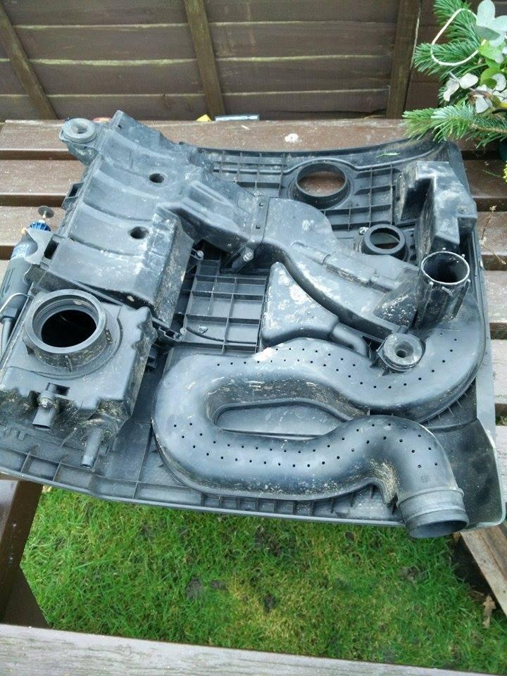

This is what it looked like to begin with , the pod filter attached to the cover, kind of pointless as it has a million miles of pipe work before it reaches the engine, and I see a nice gap between the engine and battery box  :evilgrin: :happy2: :driver:

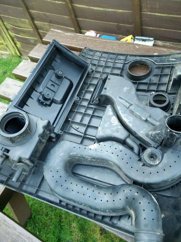

Now once you have that, you can remove the stock filter box or leave it on, I was fitting a new bit as the mounts were broken so mine came off, but i did find it helped later having the space.

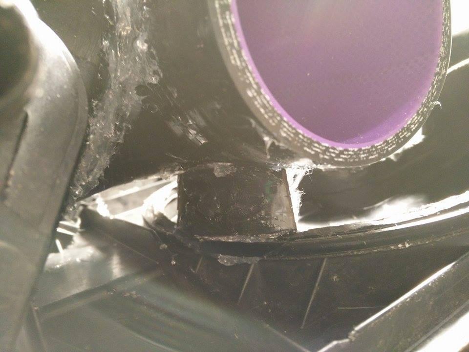

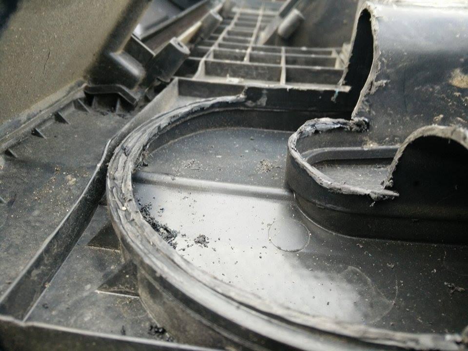

Once you can done that, time to start cutting, I cut a section out using a hack saw and a dremel. Then used the dremel to cut the final bit on and snap it off as I struggled to get it all the way in.
Time to smooth off those edges, the dremel and sanding attachment comes in handy here.

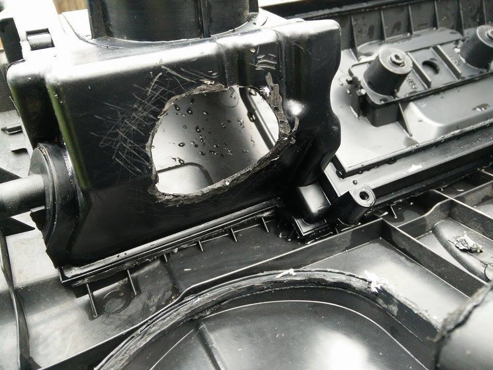

Next up is cutting a hole, a hole saw would help massively here but I couldn't find mine so had to use the dremel (It was cleaned up after)

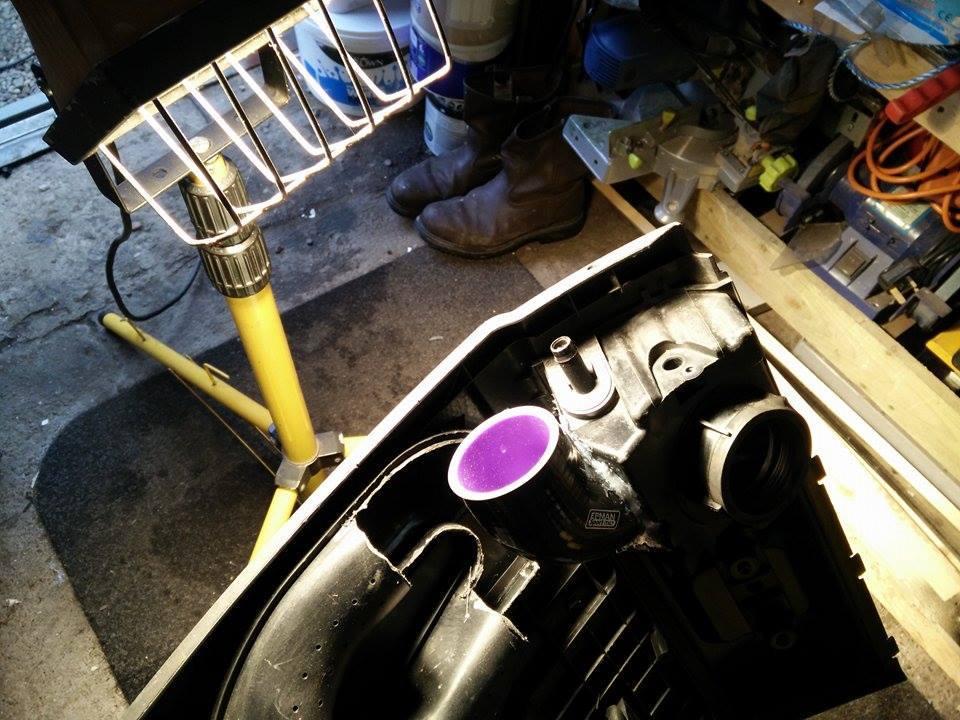

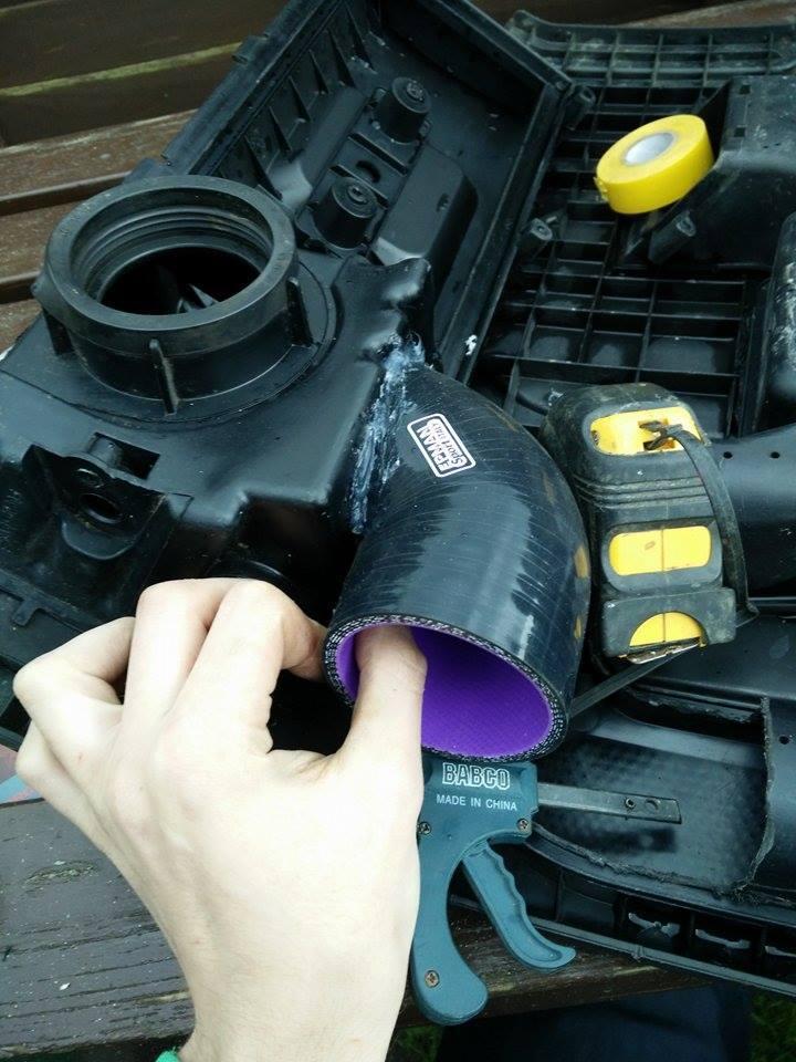

I missed a picture but you need to cut one of the hoses at an angle to help it sit flush with the box, you will see what I mean if you do this yourself. After that you need to start sticking it on, get the silicone adhesive out and start putting it on, a g clamp would help but again mine had gone walkies so I held it for 5 mins then propped it up with random stuff.
It was taking too long to set, bring out the heat!

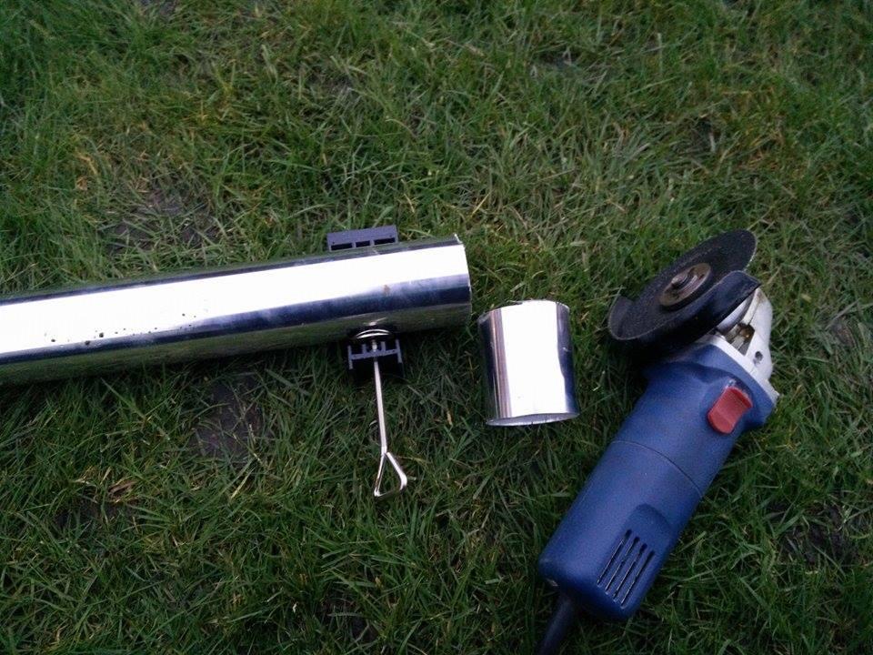

Once its set reasonably hard, place it back over the engine (dont need to clip it on) and start measuring up what lengh straight bits you need, then get cutting, I used a 7cm and a 20cm.
Not nessory but I created a little support bracket out of a bit of scrap metal and an old bike QR and attached it to one of the spare holes that are used to hold an air box on.
Cover back on, I left the standard paper filter in there for now as I was short on time but plan to plasti weld the gap up so there would be no need for it.

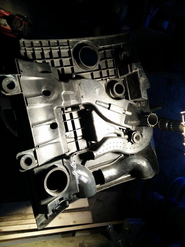

While it was drying, I used some of the cut off hose to help support it by wedging it between it and the cover and siliconing it down

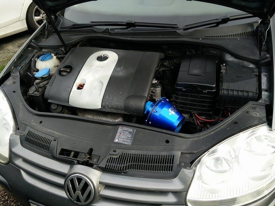

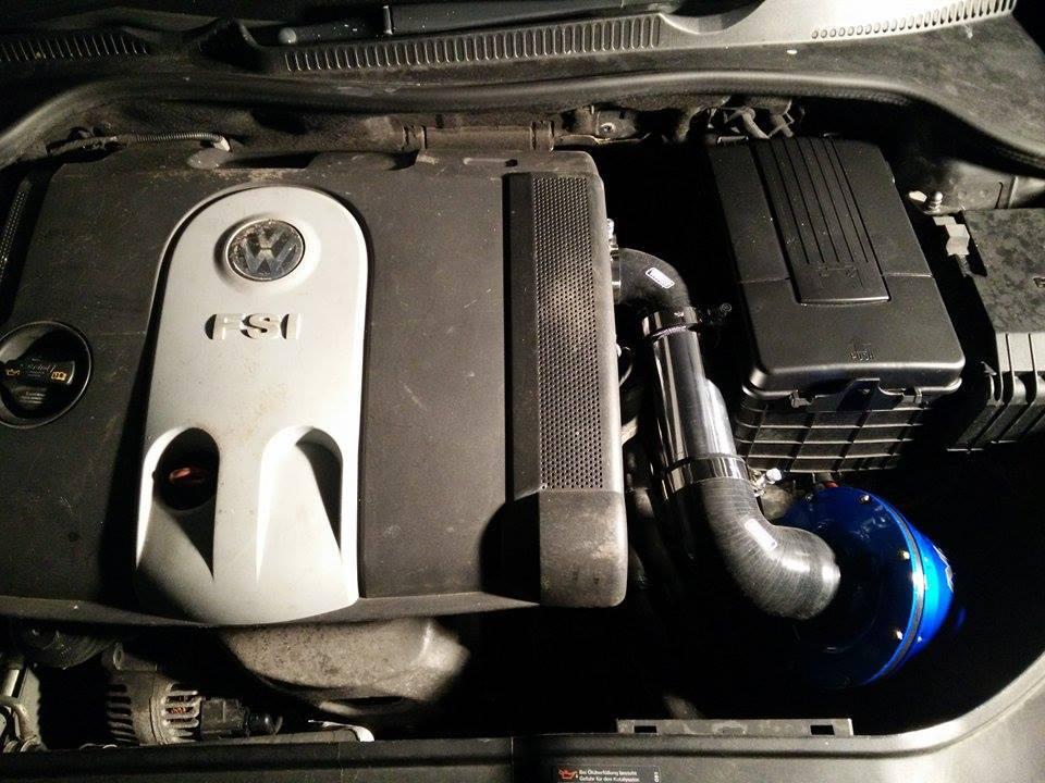

It was dark and cold by the time I was happy the silicone had set so didnt get many pictures, but basiially you attach it back to your car the way you normally would, then gently start pushing the bits together, you can put a few bits together first like the filter and the bend to make it quicker and easier. Once youre done it should look something like this  :jumpmove:
The edges are a bit rough but for a first attempt I am pretty happy, if I had longer I would have taken my time more and got it spot on  :driver:

What was the main reason from changing with your initial setup in pic one?
does the mile long pipe effect it that much?
As to me, its still getting the same temp air as it was before?
Asking as i would like to do the same :)

Main reason is that if you look under the engine cover you can see how long the pipe work is and how restrictive it can get in parts, as well as the sound :P
Air temp I do not know about, it is now wrapped in gold heat reflective tape so i imagine it runs fairly ok as this is what most induction kits do but it is a lot shorter than say a gti induction so cannot see why it would get any hotter than them :)

There are a couple of things I was wondering though about the stock cover and hoping someone can help explain.
1 - why are there a load of holes drilled in the current snakey ducting... surely that's massively going to heat up the air?! So would covering and insulating this help to keep intake air cooler?
2 - the other lower pipe work that fits to the front of the engine and into the pipework as well (I'm right technical me!) Can anyone explain what thats for as having feed directly into the intake baffles me.
Sorry if these are dumb ass questions I just want to understand it a bit better cheers.
