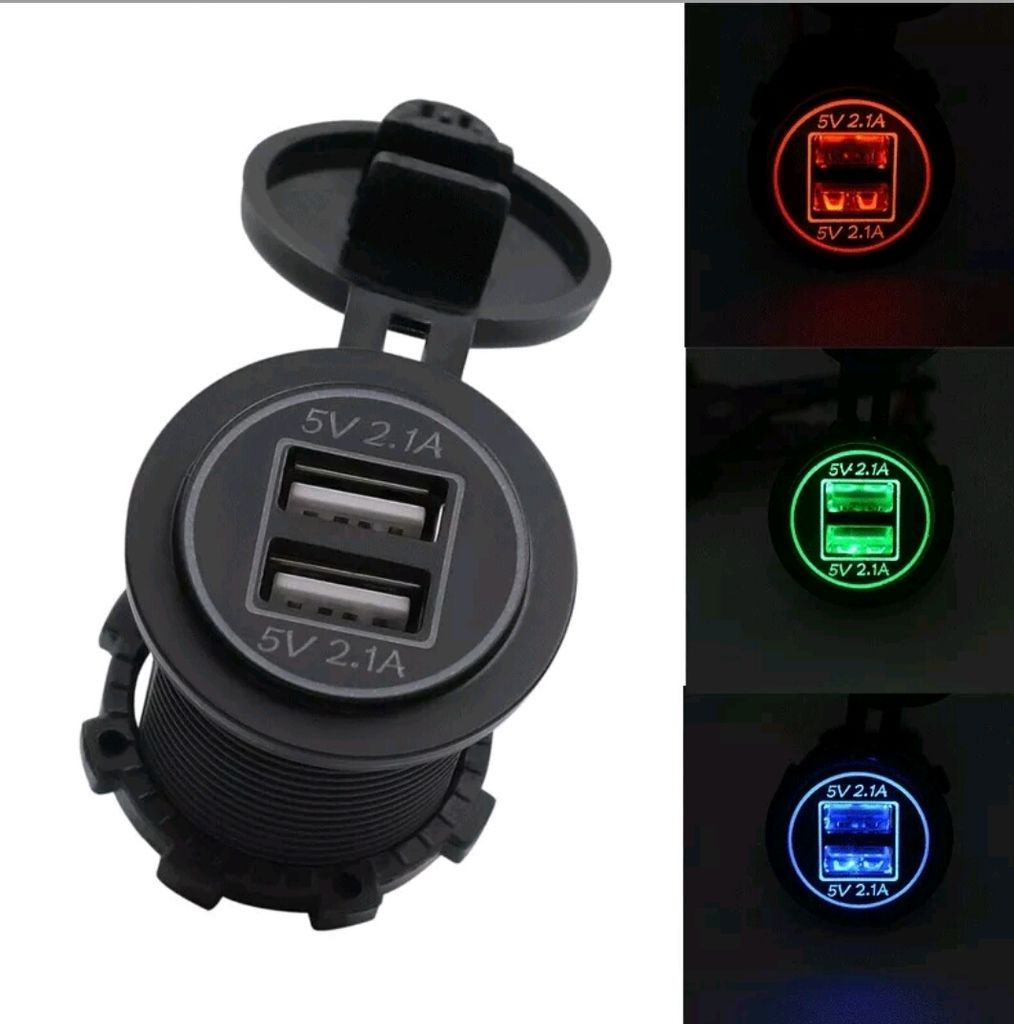

Hey guys,  has anyone fitted a usb adapter mod in the rear of the car? Maybe in the rear part of the arm rest so the rear passengers can charge there phones or power tablets?
Whenever I go on long trips I find I have to use long usb cables to run from the front cigarette socket to the rear so my kid can charge his tablet and watch films.
I've seen on ebay you can buy 2.1amp dual usb sockets and was thinking to cut a hole in the rear arm rest somewhere to fit it then scotch lock the wires from.the front cigarette socket to power it.

Neater, and you wouldn't have to cut a hole in the trim just leave the cable tucked out the way. Stick the square module inside the arm rest plastic so it doesn't rattle about.
https://www.ebay.co.uk/itm/DC-DC-Converter-Module-12V-To-5V-USB-Output-Power-Adapter-3A-15W-VP/163159738757?epid=1864527792&hash=item25fd140985:g:M6QAAOSwxblbMudv
Can just wire it to a 12V feed - just get a piggy back fuse and a bit of wire to the length you need.

Arm rest plastic? I think the golf inside is a piss poor design really. I mean theres an ash tray in my rear drivers side door but not rear cigarette lighter.. an there's cup holders that you don't really need.
I think I'm gonna run two thick wires from the front cigarette socket and then down the centre console then cut a circle in the rear arm rest and fit the one I pictured. Will be a permanent solution and I'm sure "pimp my ride" would have do that
