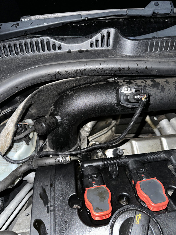

Once the car was recovered home I checked the oil level and around the engine bay, to which I found all splatters at the rear and around my cam cover breather and there’s no clear oil level line on the dipstick and it was full at the start of my journey.

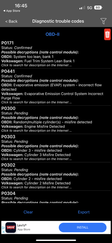

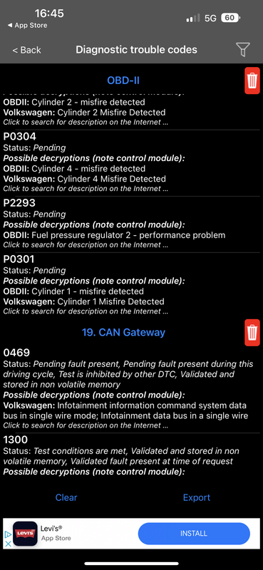

After plugging it in to OBDII I can see all cylinders misfired along with a fuel pressure regulator 2 code.
I have attached the codes in the pictures below, TIA

I would say it sounds like a massive leak in the PCV system - letting in non-metered air, the ECU dumping fuel in to compensate for the amount of air - but the white smoke is confusing me.
I would look into where the oil sprayed out onto your intake is coming from, your bonnet may give some more clues.

I recently renewed my PCV less than 1k miles ago, but when I was looking in my engine bay yesterday the bottom left screw on the PCV seems to of lost it’s thread so is just spinning. I don’t know if this happened from over tightening said screw and whatever material it screws into is worn away and I just didn’t notice at the time?
