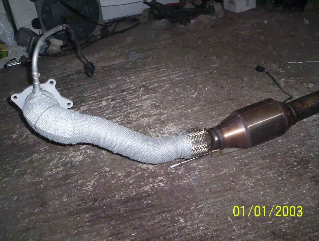

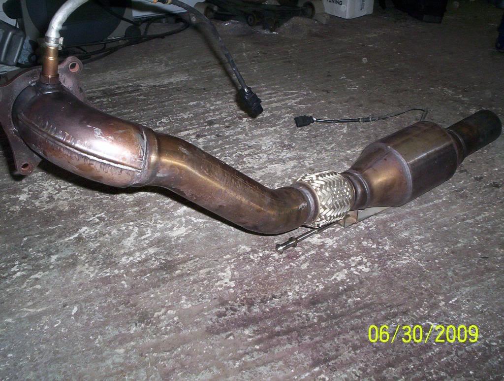

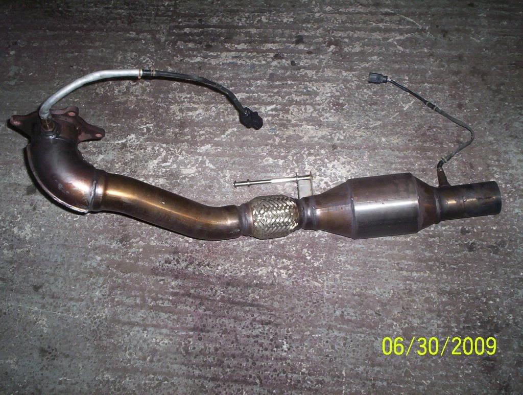

1.ok First off, your going to need to take off your downpipe. Very easy 4 bolts.( use release oil a few times as bolts will be tight )
2. Give your DP a bath. When you are driving your DP collects so much crap from the road.. its grease.. oil and what not grime. The heat wrap needs to stick to the DP and not this Grime and Oil.

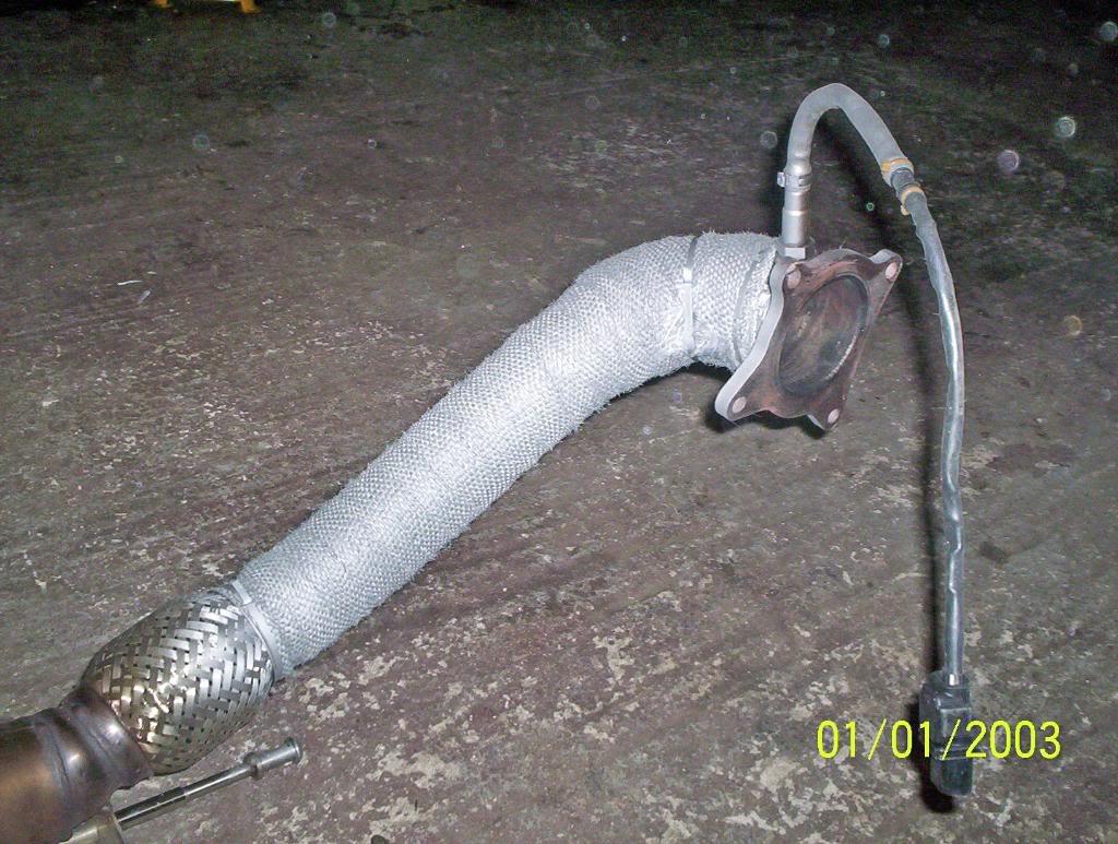

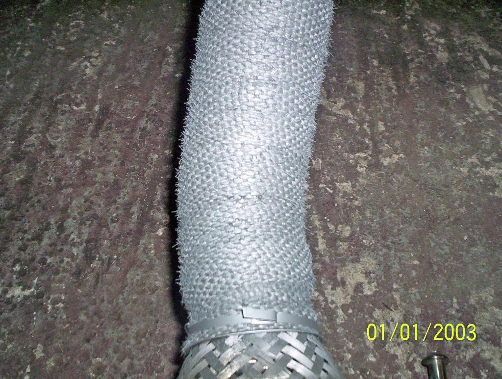

3. Spray your heay wrap with a water bottle. Do NOT SOAK!!! A nice quick spray does it nicely, or do it the hardway and dip it in water. Start wraping at the Flange that bolts up to the turbo. Overlap 1.4 of each layer in a very tight spiral. Make sure You are pulling the Heat wrap to make it tight. you can actually use painters tape along the way down to help secure it or  Heavy-Duty spray adhesive (optional) used to stick heat wrap DP. Like every 10 times i wraped down the DP I would put a tight ring of Painters tape around just for a tight fit. **Make sure the only metal showing is the flanges on the beginning and ending of the DP. Cover the whole thing**
4. Once you have wraped your DP Get your Needle Nose Pliers and the Snap Straps and put one on the beginning of your heat wrap. One In the Middle(just for mental security reasons) and one where the DP connects to the end of the DP.
5. If it feels tight, then you did it right. Then Lightly Spray the DP again with a water bottle so the Fibers of the heat wrap stick to the DP. Let it sit in the sun or a heat lamp,warm room.
6. Once the DP is Completly Dry!, spray with Hi-Heat paint, which seals the pores and protects from moisture. This is optional but i Highly reccomend it! Dont over spray, just make sure its enough to do the job. Let this also sit for an hour-to hour and a half. Two or three coats required
7. Reinstall your DP!

Spray the header wrap with water or soak in a bucket of water to ease installation and reduce the amount of fibers that come off of the wrap. Note: Not all header tapes should be soaked in water prior to installation. Consult the manufacturers specifications to make sure you can soak the header wrap with water,also as it dries out ,it tighten thought shrinkage. :smiley:
