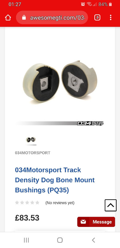

Thinklng of upgrading mine to these has anyone used them and are they any better than oem ones with the insert in the bush

I’ve the similar THS full rubber mounts on mine
NVH is way too much albeit the gear changes are silky smooth (dsg)
I’m replacing very soon with OEM ones again as I can’t bear it anymore
I personally wouldn’t recommend it

Cheers for the info sort of in the same situation..was the nvh pretty bad

Lower rpm the whole car would vibrate
Honestly it’s been bugging me since I installed it but just haven’t had the time to replace it
As crazy as it may sound, I’d choose the jerky downshifts over the vibration!

I wouldn’t be using track durometer bushings on a road car...

Sounds like you are a customer for a pair of new OEM side mounts + Vibratechnics dogbone.  That combination gives virtually zero increase in NVH.
The OEM mounts are actually OK for a few years, but they fall foul of the same rubber degradation that also affects tyres and chassis bushings.

Already changed the top mounts to 034 motor sport ones
Still not sure which bottom mount to go for as I don't want a lot of Nvh in the car

OEM will give the least amount of NVH and I'd say the Vibratechnics is a close second.
