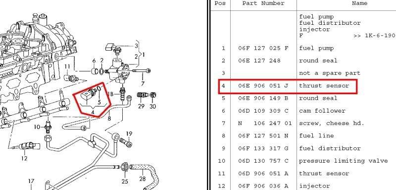

Has anyone got the part number for this G247 Fuel pressure sensor or known as Low pressure sensor!.. if thats correct??
My issue is mine has just gone to the dealers and it has come up with this fault, or several, one including a fuel rail fault or code!.... is this normal to bring other faults up on the dianostics due to just this one 'Low pressure sensor'...???
any advice much appreciated.  :surprised:
You could get the following error codes with a faulty low fuel pressure sensor aka thrust sensor
012555 - Low Pressure Fuel regulation: Fuel Pressure Outside Specification
P310B - 008 - Implausible Signal - Intermittent - MIL ON
004767 - Low-Pressure Fuel Pressure Regulation: Pressure too High
P129F - 001 - Upper Limit Exceeded – Intermittent
Just to add a correction: G247 is the high fuel pressure sensor on the fuel rail.  You were directed correctly to the low fuel pressure sensor which is on the HPFP, but it is the G410.
