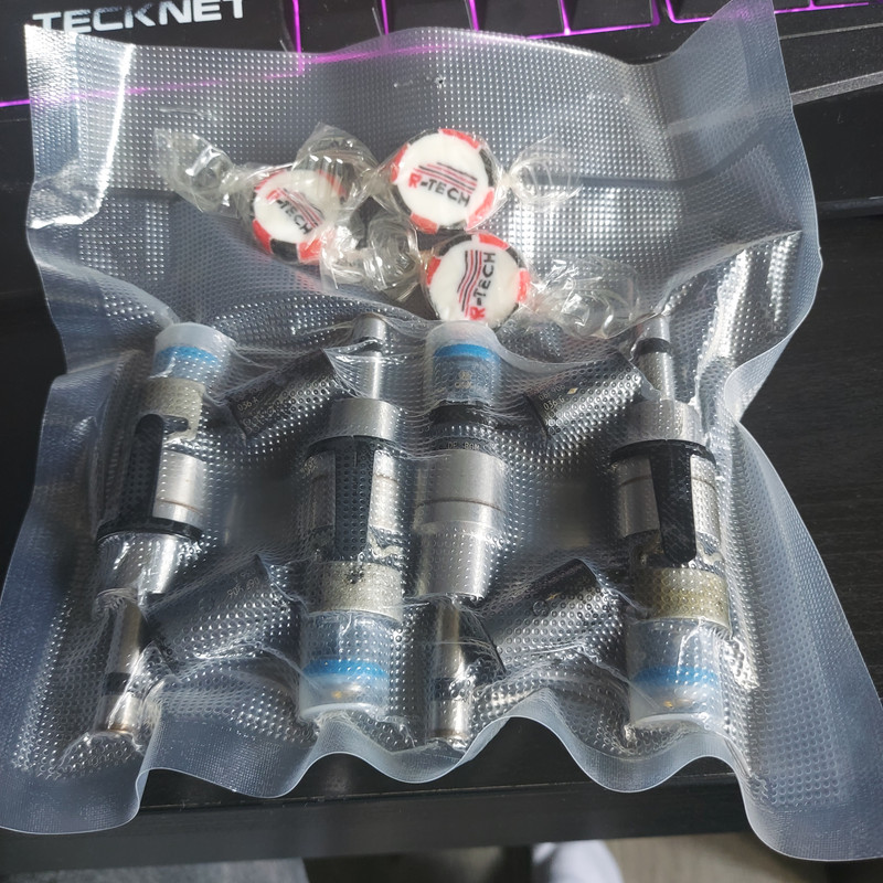

Injectors are currently on their way back from Rtech, injector 1 was faulty so a reconditioned one will take its place. Refusing to buy new still :grin:

Injectors came back from RTech along with some branded sweets! Nice aye.

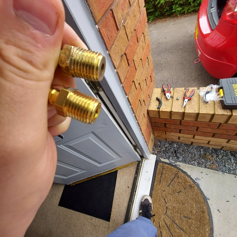

The hpfp been driving me crazy lately, just constantly leaking, ended up replacing the rubber hose and bamboo connector which connects the low pressure fuel line to the hpfp, 45 quid for that tiny little brass union :surprised:
I replaced them as it was leaking quite a lot thinking I'd messed something when removing but the new one still leaked annoyingly! When I took it off originally I could have sworn I saw something fall out of the hpfp, I tried VW and Aks tuning and both were sure there wasn't any kind of washer there and nothing they can see in the diagrams and nothing they stock or sell. I decided to just get some m6 nylon washers from b and q, fitted one and boom no leaks! No idea if it's just mine that needs this for whatever reason or if all hpfp's have this but it's just not listed. Drove me a bit mad anyway taking it on and off god knows how many times.
And now it's actually running it idles so beautifully when the injectors have just been cleaned, never lasts long I've found but is satisfying :grin:

Yes mate, there is an aluminium washer under each brass fitting apart from the schrader valve one  :grin:   Everyone makes that mistake  :grin:
Glad it's sorted for now, but you will need to get the proper washers in there at some point  :happy2:
