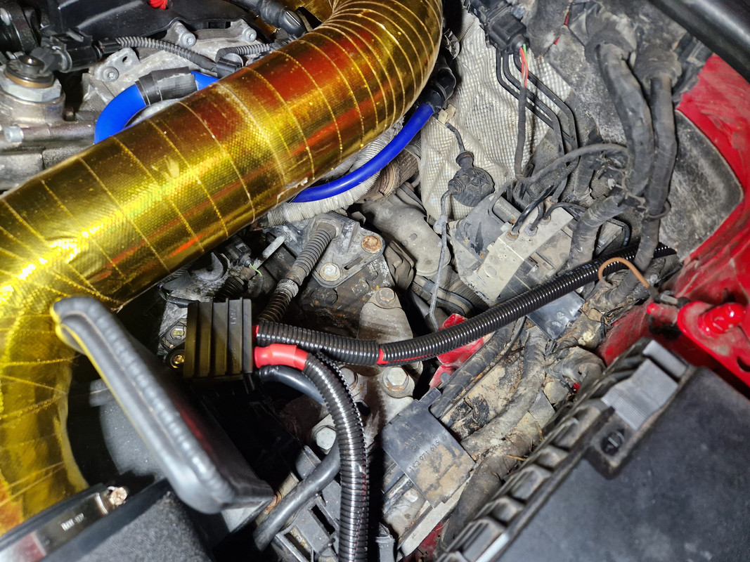

Removed heater core and got a 180 degree ally tube re-route it. I still need to get another jubilee clip and some foil tape and secure it though.
blank silicone plug too
Full setup looks like this to delete the entire heater core and AC:
started gathering wiring. its very scary to start getting it ready to remove and hoping nothing breaks dramatically but a good learning point. I have heard of some other cars of similar age ditching over 10kg from just wiring... I don't think we will ditch that much as its still going to be mot worthy but I will be happy with half that frankly.

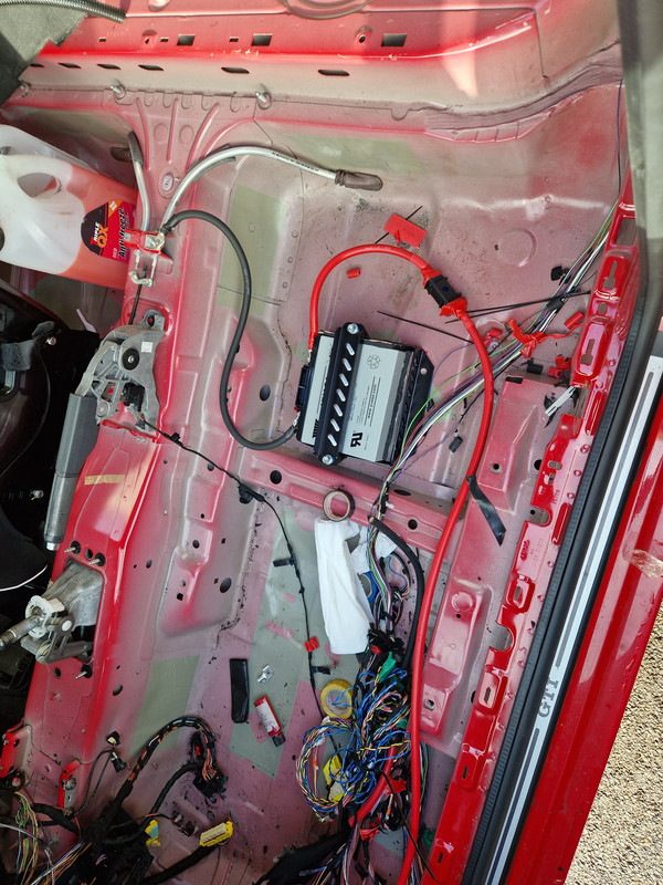

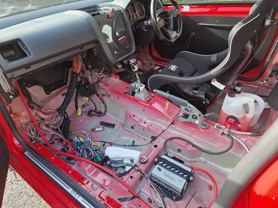

Battery relocation done!
Trimmed the battery bracket so I could use it to mount a transfer box for the starter cable and the positive cable
Placed the battery then behind the passenger seat. Opted over the boot for a few reasons... simpler install, less cable required, closer to the moment of inertia so can help rotation. Should also help the cross weights a little. Its just a cheap 50 quid mobility scooter battery, starts up fine though! There is a lot removed now though, including the comfort pack so really not many electric modules or features still left to manage.

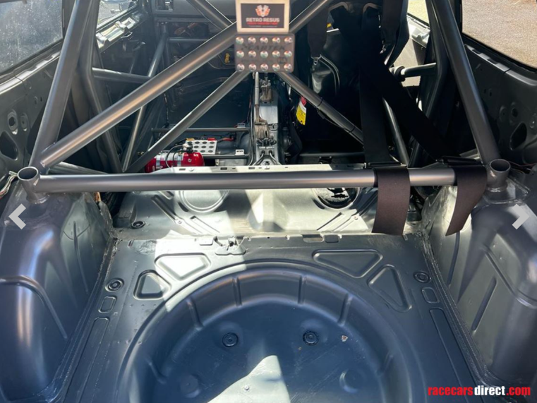

MOT man mentioned the bearings were going... had a bit of wheel wobble too. Its been sat for a while so I just took all the wheels off sanded down the hubs really well, re-greased and torqued wheels back up and got the tyre pressures right and its fine now! I wonder how many people fall into a false negative and end up paying 200+ quid in part for bearings or double getting the garage to do it.

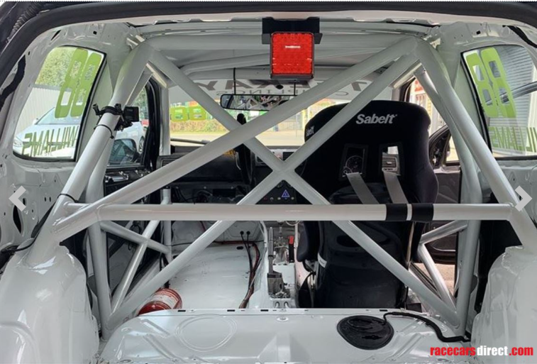

Also car is officially booked in for the cage  :pomppomp: lots planned, lotta money too :grin:
I've done a bit of research on cages to get it booked in. So gone for the Production GTI Spec cage that Retro Resus provide with some tweaks so overall its a 6 point cage with a rear strut brace, dash bar, rear X, hoop X and driver seat weld in mounts. The rear strut brace and dash bar make a big improvement to rigidity, have gussetts on A + B pillars do too but not to the same level after some research, they do look awesome though but that would add quite a good chunk of cost to overall build so I left that for now.
This gives you an idea what the outcome will be, these are some retro resus Production gti built cars
They're also going to strip out unnecessary brackets, and trim the boot, and ditch the crash bars and excess metal in the doors themselves and replace front windows with polycarb ones. So after all that it should negate the weight of the cage or be very close anyway. No idea what to do about paint yet :grin: Although it will be done at a warmer and dryer time of year so no manic rush to get that sorted.
They're also going to fit Aerocatches to the boot, and strip out the massive chunk of leftover wiring, and then its a geo setup and good to go!

Sneak peak today. Went in for a seat fitting so they can weld in the seat mounts in the best location for me. Unfortunately I took terrible photos :grin: but looks great so far. Tubing is as close to the chassis as possible, welds look beautiful and the bends are super smooth rather than sharp and weak. Still lots to do of little jobs but the big job is done, need to start working out my paint strategy now. If I lived somewhere hot I would probably leave it as its a shame to cover up such lovely welds and beefy looking steel tubing, but as with everything here it will rust...
I have seen a couple of mk5's out there with the tubing welded to the floor instead of rear turrets which seems either a massive oversight or juts a cheaper/easier way to do it. Not sure why you would leave the opportunity to link the rear turrets together and attach the cage to a stronger parter of the car as opposed to what I presume it double skinned flat sheet steel..

Now the Mk5's are getting older I really appreciate a perfectly restored mk5 though I must say.
So 2 months later and the golf is back... I almost forgot I had a golf to be honest :grin:
I love the back of it now...
The doors have been lightened quite drastically and so has the bootlid but I forgot take a pic of that along with majority of brackets ditched.
So within an hour I decided to start taking it all apart again :grin: time to prep for paint! Also you can see the cage a bit better here
I am not sure what colour yet still... I'd love to leave it as bare steel but that is not practical. Currently I'm thinking red to match-ish or go for a grey/silver.
I do have a couple jobs to do before taking it out again. Most Importantly the top mounts... Retro Resus told me they really do not like the Compbrake top mounts on there because they do not engage the strut with enough threads and said they did not think they were a quality product at all. They've advised ground control (obviously, everyone raves about these but £££) or Silver Projects which I was surprised at as they're quite inexpensive I assumed maybe not the best quality but they said they reliable and well made and consistent so I'll be ordering these in soon.
We got to talking about dampers too, I was considering getting GAZ later down the line but they advised against these and said the quality is poor and its not something they would ever advise to fit. They mentioned their favourites for the mk5 were KW Clubsports, Ohlins, AST etc. which you could have probably guessed as these are some of the widely known top performers, otherwise they said they also rate the ST XTA dampers, aside from those they said there are not many others they would recommend and said you won't be gaining much by ditching the bilsteins for other similarly priced dampers typically and the b14/b16 are dampers they like recommended sticking with them.
So that means ditching the front linear springs :( the rears can stay though which I am currently debating whether to go back to  bilstein springs or keep the rear 450 pound springs  which are as stiff as the fronts or thereabouts but are linear. I guess I'll need to do some testing if I want to keep them in the rear.
