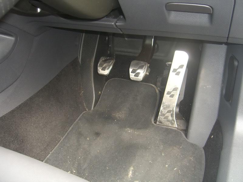

here you go, from my build thread:
Not really had time to play with the car, but started tinkering this weekend as the Mrs has given me the weekend off  :grin:
First job was to fit the groovy new dead pedal cover i bought from gulfstream at Inters, i promised a couple of people a How-To guide so here we go
dont fear it, it's dead simple and should take no more than 10 mins
this is how we looked before:
With the clutch, brake and accelerator all getting the metal treatment it seems so natural for the dead pedal to follow suit and tidy things up

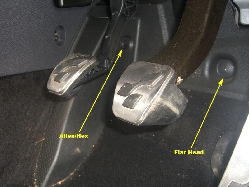

first step it to remove these 2 screw heads
dont go at it like a bull at a gate, they're only plastic and will shred easy so take your time  :happy2:

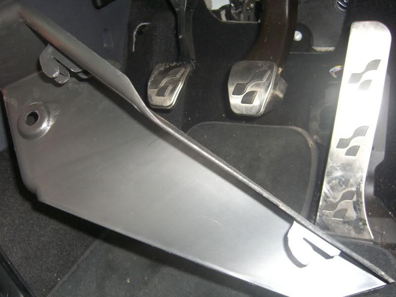

once out the whole panel is now free, if you look at the shot below you'll see it needs a gentle push upwards and then will pull towards you

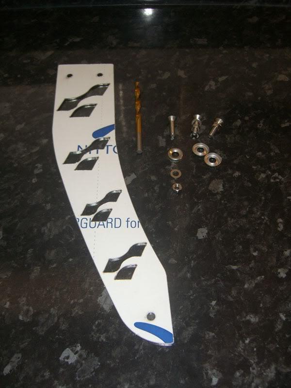

I was tempted to markout the metal in place but its made so well theres no need to. next is the kit, it came supplied with fitting kit, and you will need a 5.5mm drill bit (5.5mm rather than 6mm as then you can drill through the plate and into the plastic ensuring accurate fit)

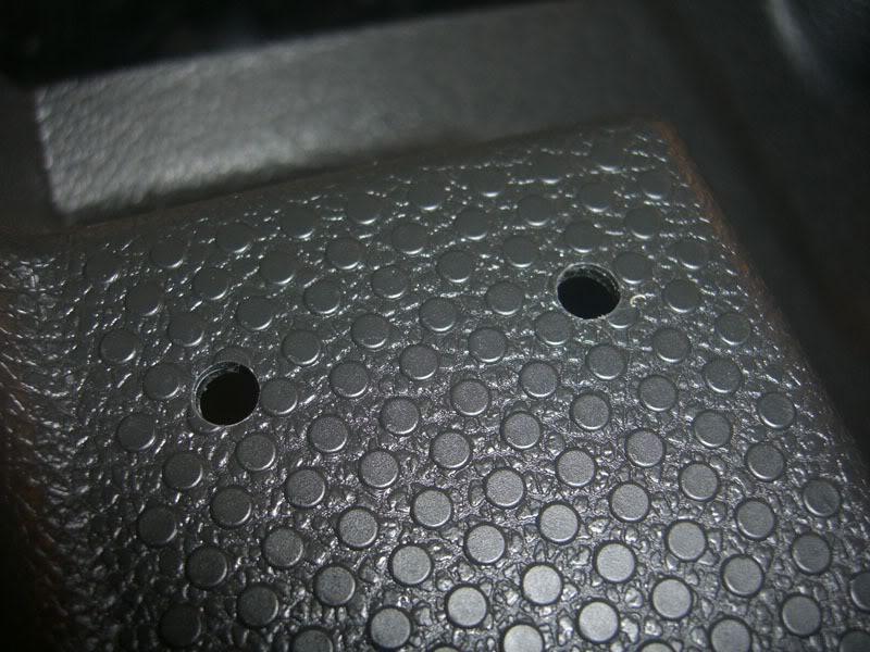

drill on slow speed with pressure and nothing will melt...like so...

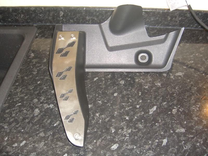

all bolted up, socket on rear allen on front...

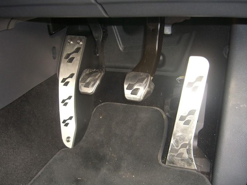

and installed into the car:
now pat yourself on the back for a job well done  :smiley:
