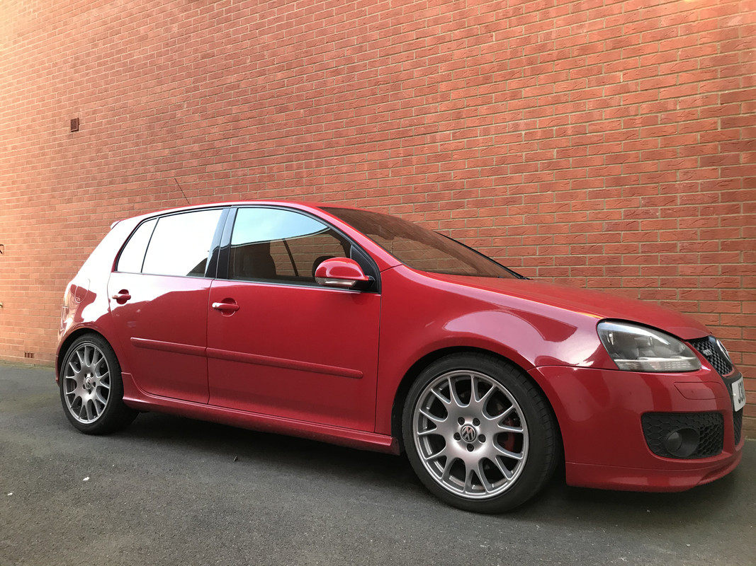

« Reply #9 on: April 03, 2021, 11:35:20 am »
The STs are model specific I think.
This is the -20mm kit fitted to my Edition 30.  I have the thicker TT rear spring mounts on mine, so is sitting a little higher at the back than normal (approx 5mm) but I wanted the OEM slight nose down stance anyway  :smiley:
