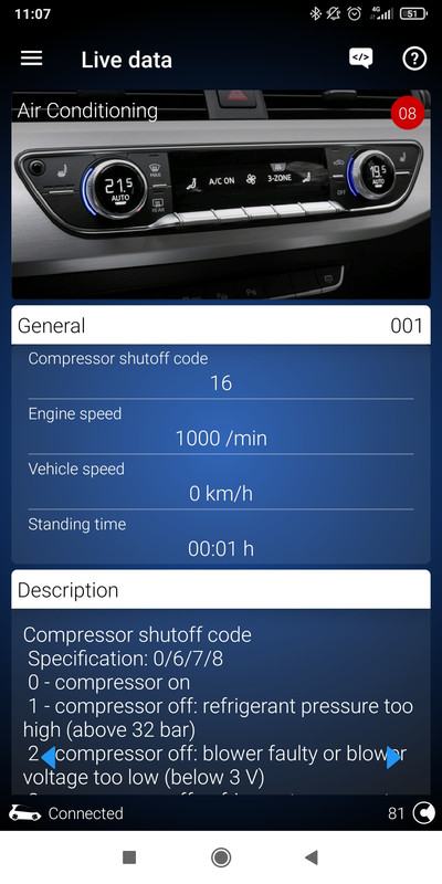

Only blowing warm, clutch is engaging and the bolt in the middle is spinning with it. Fan isn't starting though. Been to Kwik fit and the car has no leaks according to them and is holding gas. Here is some info. From obdeleven...
So going from above its saying the compressor is rotating but possibly not getting the current it requires? Or am I reading that bit wrong. Thanks

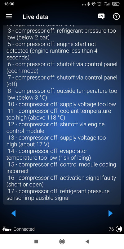

Code 16 not activating.
I know the high-pressure switch is common on mk5s.
Is there any fault codes in hvac?
https://euroautotraining.com/blog/late-model-vw-ac-compressor-shut-codes
16 = Compressor off (activation A/C Compressor Regulator Valve -N280- implausible)
N280 fault maybe then?

Fault mode 16 points to the N280 being faulty or not being activated, which can be the pressure switch.

Decisions  :thinking:. It's working out about the same price to change either the pressure switch or the solenoid.
Pressure switch £70
Solenoid £20 plus regas £50
Assuming I can change both myself. Any ideas on what the most likely culprit is bearing in mind the shut off code I have? Or would the fact the compressor is not getting the correct current/fan not working point us to either the pressure switch or solenoid?
