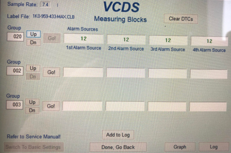

I have also had the "alarm triggers" checked in the block data in cent. convenience. These show "12" across all 4 fields! I don't know what "12" is could anyone help? This would at least point me in the right direction of what could be wrong. I am thinking it's the alarm siren and shutting the bonnet somehow disturbed it. Or maybe it's the passenger door lock just getting worse but showing no symptoms? (the codes for that door have been there since owning the car and I have only just started to get this alarm issue)
